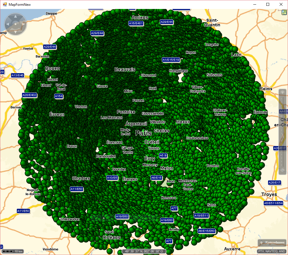

The computatio of a 6000x6000 matrix can be done within less than 1 minute (my local example took 45 secs), but my stomach tells me we are on a wrong path.
Let's get several steps back:
Imagine you could wish a blackbox function where you provide a given input and describe the required output.
From a functional usecase point of view (forget each method of xServers for a moment):
how would the signature of the function look like?
I think I might provide a better solution for the original task then...
coverage of 7000 (!) locations around Paris. Computation time: 60 seconds.

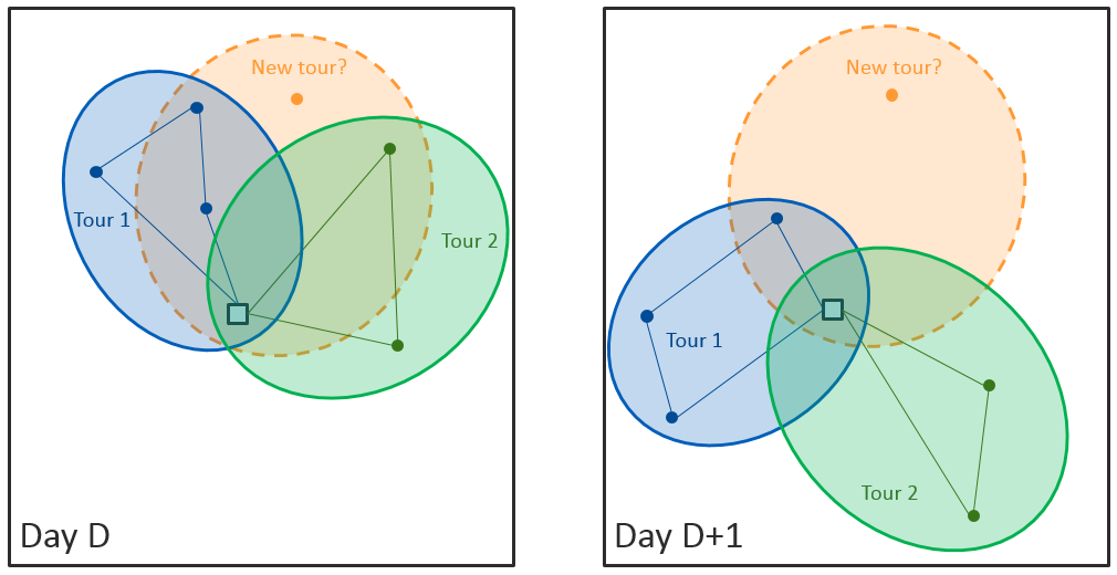

In fact I have a lot of vehicles tours on several days (from a date D to D+14). Some are full, some not. For a new given customer :
  • 1- I want to know quickly what vehicles can visit this customer
    2- If no vehicle can visit this customer, I want to know at what date I should open a new tour to visit this customer. And here is the point, I don't want to open a new tour on day X if this new tour's area intersects too much tours areas (on day X). For a given day, I finally want to cover my map as much as possible.

Here is an example :)
I have two tours on day D and on day D+1. I have a new customer to visit and I may visit it on day D or on day D+1. This customer can't be visited by vehicle 1 or vehicle 2 so I have to open a new tour.
Is it more efficient to open a new tour on day D or on day D+1?
Here this answer is day D+1 because the new tour will cover 80% of the area defined by tour 1 and tour 2 on day D. On day D+1, it will only cover 20% of this area.
The approach mentioned by Ralf is a good idea but it requires to determine the set of potential customers and the only way I see to do that is by slicing my map...
Charlie

Posts: 2968
Re: Detour points
Ah, I see. But that's a different target then.
If you want to optimize reachability and coverage you might take a look at this feature of xCluster:
http://xserver.ptvgroup.com/forum/viewt ... f=10&t=482
Not exactly what you are looking for within this thread but related to "how to cover a broad area?".
