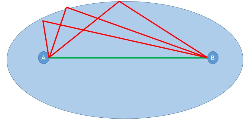

You want something like the blue ellipse, the geometry?
&quot;Distance&quot; between A and B is smaller than the available horizon, so there is a search space to be reacheable
"Distance" between A and B is smaller than the available horizon, so there is a search space to be reacheable
I assume we don't have a function for this but maybe you can use some simple (A:N) + (N:B) matrix requests?

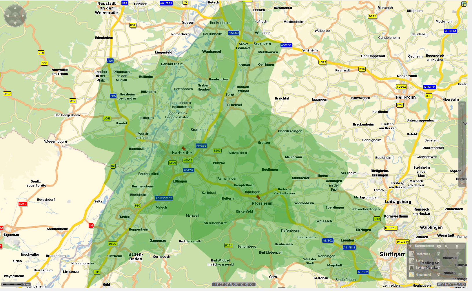

Two 30min isochrones, checking for 1 hour. <br />Any point outside both isochrones will not be a candidate for the given task.<br />Any point inside both isochrones is reacheable within 60 minutes.<br />Attention: doesn't guarantee anything for points inside exactly one isochrone.

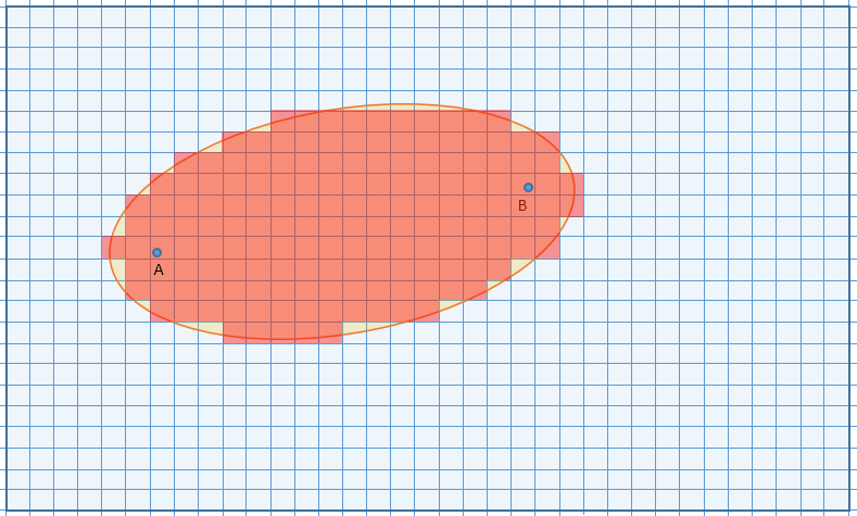

Could you provide an image how you'd like to slice the map?
I don't get the point :cry:

Here is a map example :-)
Yeah good idea! I could first define the area with two isochrones and then calculate the "squared" ellipsochrone with (A:N) + (N:B) matrix requests.

- 30 minutes to go from A to B<br />- I have 60 minutes to go from A to B<br />- I want to know the area containing all the points that match the condition (A:X) + (X:B) &lt; 60 minutes
- I want to know the area containing all the points that match the condition (A:X) + (X:B) < 60 minutes
