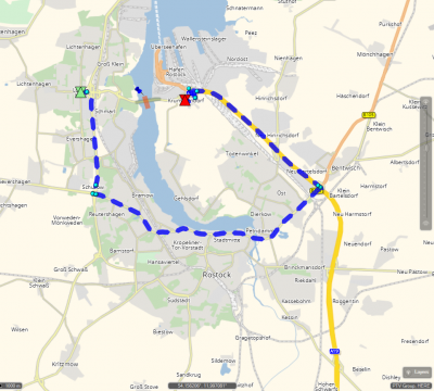

PS: with xServer 2.26 we invented a new geographic restriction: prohibitedSegmentsByIntersectingPolylines
This enables users to block segments on a stable, coordinate based selection.
I applied this on the WarnowTunnel:
Looks good!
The benefit: with this approach you don't have to recreate your custom feature layers with every map update!
prohibitedSegmentsByIntersectingPolylines = ["Linestring(12.092431 54.136726,12.094478 54.132741)"]

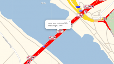

2024.1H : Truck attribute still set to "maxWeight = 3500 kg"

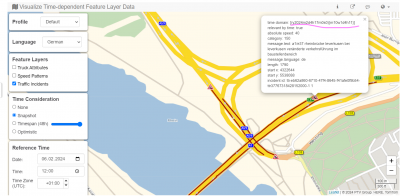

2024.1H : current "traffic situation" given by TOMTOM HD traffic (event started 4.2.2024 - expected to last 10 months - impact: speed reduced to 40km/h)

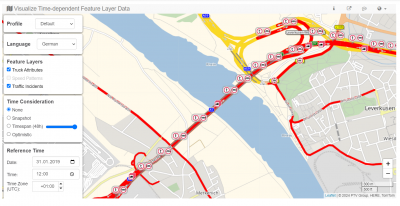

2024.1H

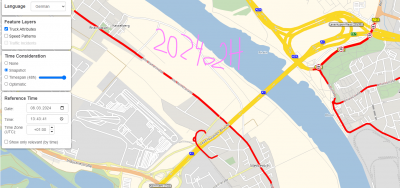

2024.2H map: no critical attributes in the bridge

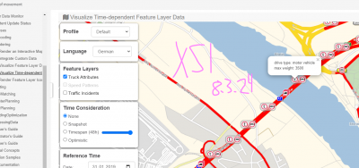

2024.1H map : the bridge is blocked via PTV TruckAttributes
