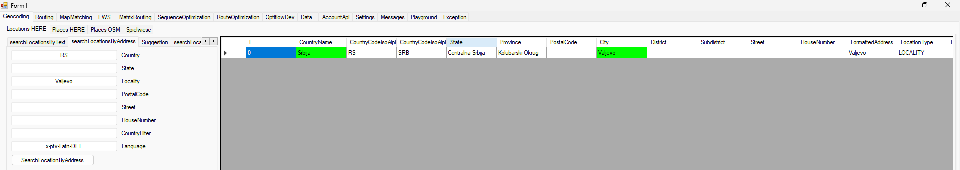

Posts: 3018
Re: xLocate2 Cyrillic vs Latin
Hi Remco,
in the upcoming version of xLocate (v2.34, expected for mid/end of october) we will also support "x-ptv-Latn-DFT" which will then return the result as expected.
This value is already supported in PTV Developer:
  "country": "RS",     "state": "",     "locality": "Valjevo",
  "postalCode": "",     "street": "",     "houseNumber": "",
  "countryFilter": null,   "language": "x-ptv-Latn-DFT",
  "results": [
    "ADDRESS_SCORES"
returns:
  "locations": [
      "locationType": "LOCALITY",
      "referencePosition": {
        "latitude": 44.273788452148438,         "longitude": 19.890300750732422
      "address": {
        "countryName": "Srbija",          "state": "Centralna Srbija",
        "province": "Kolubarski Okrug",         "postalCode": "",
        "city": "Valjevo",
        "district": "",         "subdistrict": "",
        "countryCodeIsoAlpha2": "RS",
        "countryCodeIsoAlpha3": "SRB"
      "formattedAddress": "Valjevo",
      "quality": {
        "distance": null,
        "totalScore": 100,
        "addressScores": {
          "country": 100,
          "city": 100
PTV Developer test
PTV Developer test
