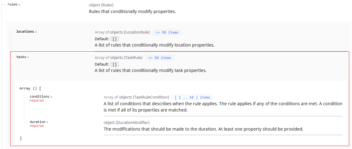

What changed?
- In v1.41, the Rules object only supported rules.locations.
- In v1.42, Rules additionally supports rules.tasks as a list of task rules.
A TaskRule lets you conditionally modify task duration via a DurationModifier.
Each rule has:
- conditions (OR-list; each condition is an AND-match)
- duration (DurationModifier)
- taskCategory
- vehicleCategory
This is a nice modeling upgrade if your service times depend on context, e.g.:
- “Forklift-needed stops take +10 minutes”
- “Big trucks are slower to handle at customer locations”
- “Special handling categories increase service time”
"rules": {
"tasks": [
"conditions": [
{ "taskCategory": "FORK_LIFT_NEEDED" },
{ "vehicleCategory": "BIG_TRUCK" }
"duration": { "factor": 1.0, "extra": 600 }
