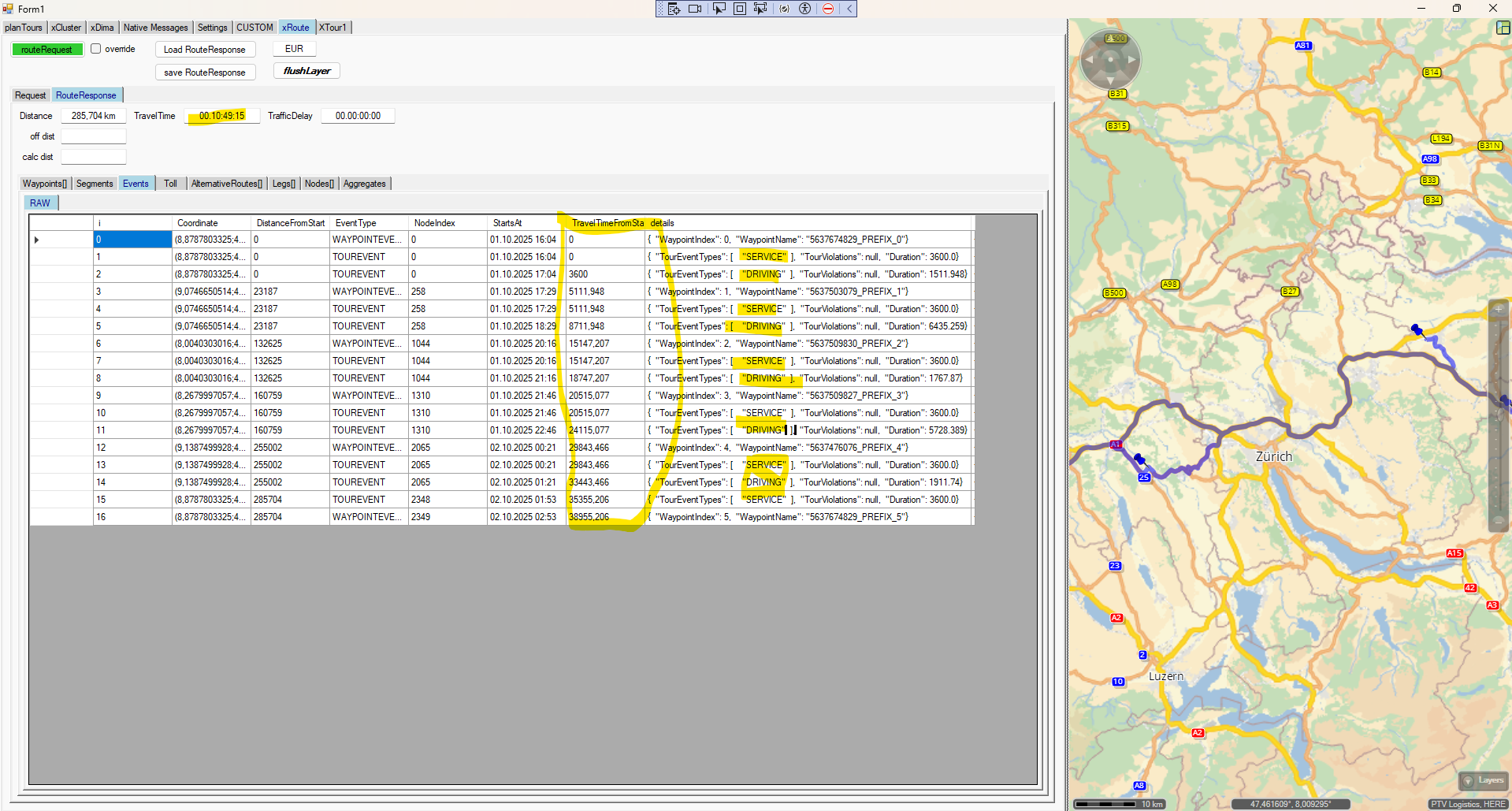

In the sample xml file attached, containing a xRoute request, in the tourRestrictions, configurableWorkingHours are added.
Regardless of the value that I set for the maximumWorkingTimeBetweenBreaks, no tour events of type Break are inserted (in the sample, it is set as low as 3600).
But as I look at this route result, there is a lot of working time, so I was really expecting some breaks to be inserted based on this parameterization (there is a lot of service time defined on each waypoint + driving time in between, so I was expecting breaks based on working time. I set the maximumDrivingTimeBetweenBreaks very high in the sample file on purpose to make sure that any breaks inserted are not due to that setting).
Note: the maximumDrivingTimeBetweenBreaks works fine, as soon as I make it a lower number (ex. 3600), several breaks are inserted.

},Bernd Welter
- Posts: 3099
Re: In xRoute request, it seems like maximumWorkingTimeBetweenBreaks parameter is not considered in configurableWorkingH
Here's some feedback from DEV (Yann via ADOS-268078):
From my current understanding this underlying fix will be part of the next standard xServer 2.39.The bug has been found.
But, this configuration is not really correct.
"maximumDrivingTimeBetweenBreaks": 32600.0,
"maximumWorkingTimeBetweenBreaks": 3600.0,
In this case, the maximumDrivingTimeBetweenBreaks is never used, because breaks will be always set because of maximumWorkingTimeBetweenBreaks.
More generally, if the maximumDrivingTimeBetweenBreaks >= maximumWorkingTimeBetweenBreaks, the maximumDrivingTimeBetweenBreaks should be ignored, because it will never happen.
For this special case, if it is the real settings of the customer, then a simple workaround would be to not set the attribute maximumDrivingTimeBetweenBreaks.
If only one of the 2 values is defined, there is no problem at all.
