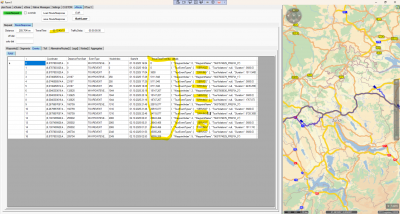

In the sample xml file attached, containing a xRoute request, in the tourRestrictions, configurableWorkingHours are added.
Regardless of the value that I set for the maximumWorkingTimeBetweenBreaks, no tour events of type Break are inserted (in the sample, it is set as low as 3600).
But as I look at this route result, there is a lot of working time, so I was really expecting some breaks to be inserted based on this parameterization (there is a lot of service time defined on each waypoint + driving time in between, so I was expecting breaks based on working time. I set the maximumDrivingTimeBetweenBreaks very high in the sample file on purpose to make sure that any breaks inserted are not due to that setting).
Note: the maximumDrivingTimeBetweenBreaks works fine, as soon as I make it a lower number (ex. 3600), several breaks are inserted.
A similar issue I seem to have with maximumTravelTimeBetweenDailyRests. It seems not to be considered for daily rest event insert. Also, if I set it too low compared to maximumDrivingTimeBetweenDailyRests (for example, set the maximumTravelTimeBetweenDailyRests to 18000), then even the Raw Request Runner stops with error "The tour information could not be calculated. The scheduling component returned an internal error."
Can you please help me understand what is happening? Is my understanding/expectation of these parameters wrong, or the way they are setup, or indeed some other issue?
