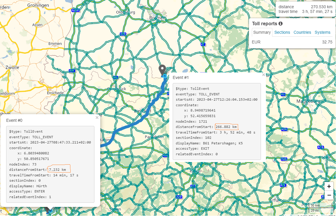

I would be very interested in requests where a section appears twice. Those would be bugs in our toll data and of course we want to fix them. There is an explanation why a section can appear twice, that is when there is a waypoint in between where you leave the toll road. If a section is only partially driven (very hard to find an example where this actually could happen), then it also makes sense that the reported distance is less than the toll distance. But I guess you are referring to routes that span several hundreds of kilometers through Germany. I assume that there are some systematic errors where our distance might be slightly lower than the actual distance whereas the official distance might be a bit greater than it actually is. I don't think you're doing something wrong and yes, there is a different way to get the total toll distance. You can request the toll events. At each event there is a distanceFromStart returned. So you calculate the difference exitTollEvent.distanceFromStart - enterTollEvent.distanceFromStart and add this up for each pair of enter and exit toll events. This should work quite well with most toll systems. However, there are also toll events of type "PASS". There it is very difficult to get a good approximation of the toll distance if no official distance is available. At waypoints there is not necessarily an exit toll event, so if you want the toll distance per leg with this approach, you probably want the waypoint events too, so that you can split the distance accordingly.

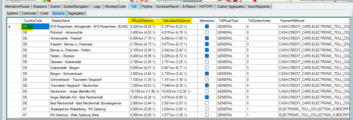

Here's another example of a routing result where the sum of the toll sections "officialDistance" exceeds the total distance (this time gathered through PTV Developer Routing API):
I'd say that the data coming from the TOLL provider simply differs from the MAP provider data which we use for the calculatedDIstance and the totalDistance.
@Max: Does this make sense?

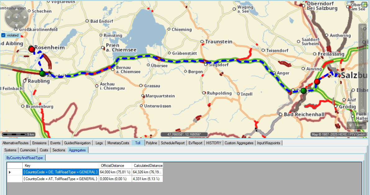

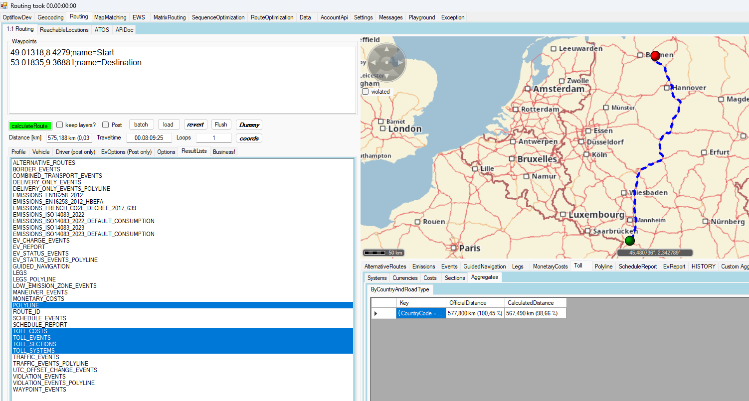

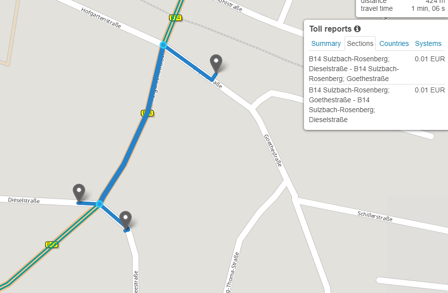

And two more samples:

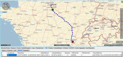

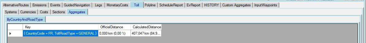

- To compute the calculatedDistance / officialDistance per country as shown in this screenshot it is necessary to evaluate the toll sections which provide the details which you can aggregate on client side:

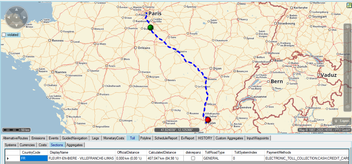

Please be aware that the official distance ist not available in all countries - that's why we have the calculated distance. Here's an example for the french route from Paris to Lyon:
The response contribution for France does not contain "officialDistance"... only the calculatedDIstance.Code: Select all
{ "waypoints": [ "48.8571701049805,2.3413999080658;name=FRA/Île-de-France/Paris Paris", "45.7591705322266,4.82964992523193;name=FRA/Auvergne-Rhône-Alpes/Rhône Lyon" ], "profile": "EUR_TRUCK_40T", "vehicle": { "lowEmissionZoneApprovals": "", "hazardousMaterials": "", "truckRoutes": "", "etcSubscriptions": "" }, "options": { "routingMode": "FAST", "language": "EN", "currency": "EUR", "avoid": "", "speedFactor": 1.0 }, "monetaryCostOptions": {}, "results": [ "POLYLINE", "TOLL_COSTS", "TOLL_EVENTS", "TOLL_SECTIONS", "TOLL_SYSTEMS" ] }Code: Select all
"sections": [ { "tollRoadType": "GENERAL", "costs": [ { "price": 114.83, "currency": "EUR", "paymentMethods": [ "ELECTRONIC_TOLL_COLLECTION", "CASH", "CREDIT_CARD" ], "convertedPrice": { "price": 114.83, "currency": "EUR" } } ], "countryCode": "FR", "displayName": "FLEURY-EN-BIERE - VILLEFRANCHE-LIMAS", "calculatedDistance": 407047 } ]
