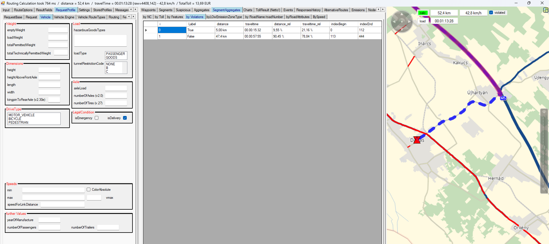

I attached an JSON (in txt file) for the Raw Request Runner.
I do not know yet how to apply your answer in that.

- Posts: 2990
Re: How to Define a Permanent City Access Permit in Route Planning
Well, this is what immediately caught my eyes:
is created by
- "distanceTimeWeighting": 100 - causes the engine to look for a very FAST route, even if a detour applies. Probably you should use values between 20 and 80.
- - means you are not allowed to use "deliveryOnly" segments. Set this value to true and...
"isDelivery": false - choose your penalties... also you did NOT specify a deliveryOnlyPenalty (default is 2500, so almost forbidden)
"specialAreas": { "residentsOnlyPenalty": 2500, "urbanPenalty": 500, "forbiddenLowEmissionZonePenalty": 2500, "minimumUrbanNetworkClass": 1 }, - - the "2" means that outside an area of 2km around any involved waypoint we do not "see" those network classes 5,6,7 but some roads in Dabas are NC 5.
"minimumDistancesFromWaypoint": [ "UNBOUNDED", "UNBOUNDED", "UNBOUNDED", "UNBOUNDED", "UNBOUNDED", "2", "2", "2" ]
