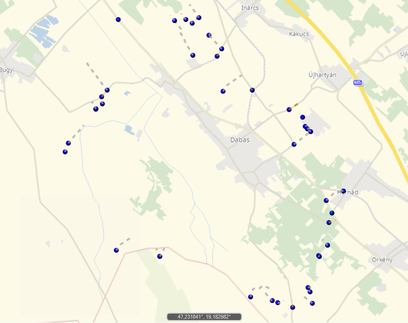

Your selected segments around the city

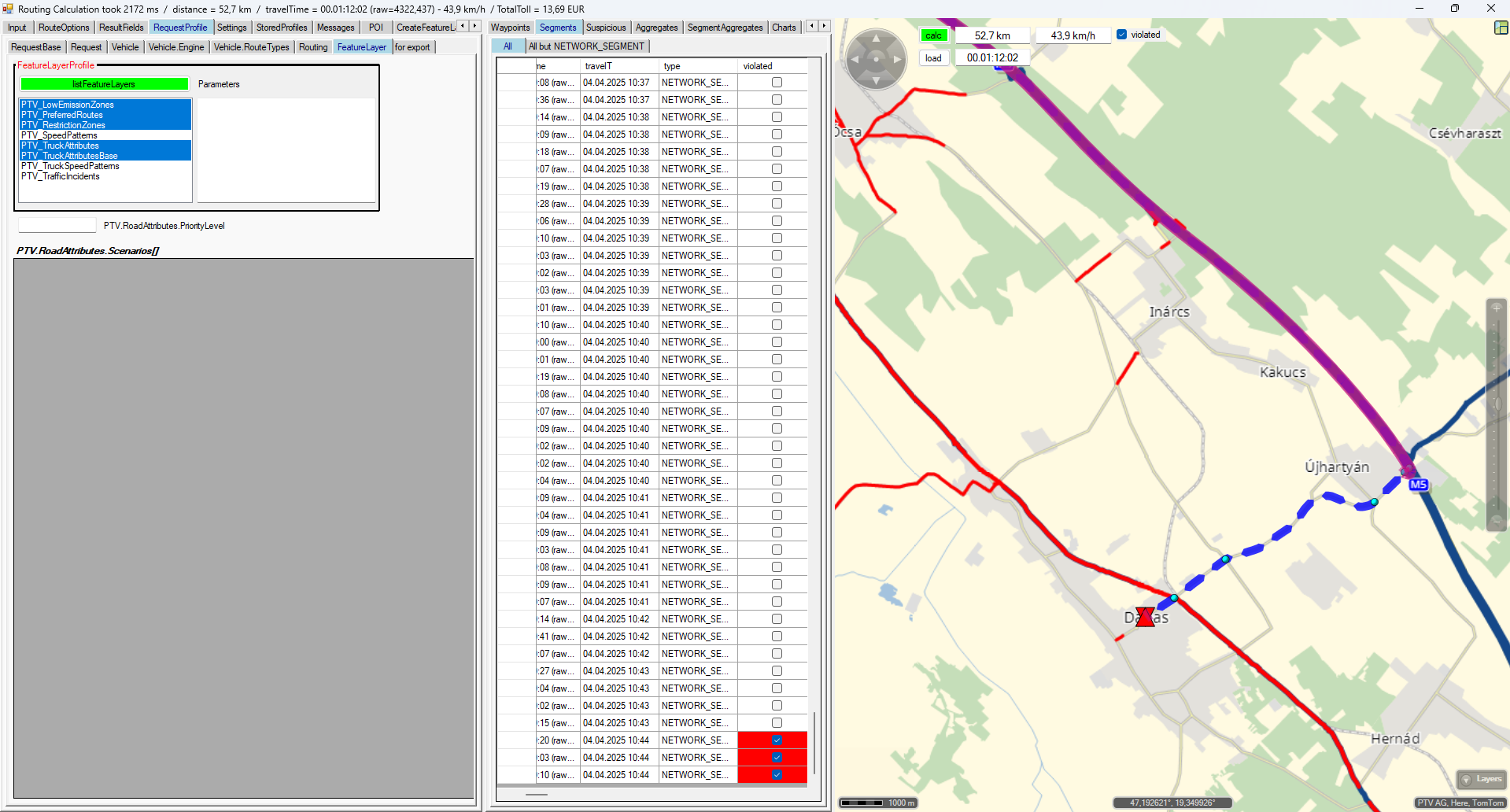

From what I see in the first reponse the segments inside Dabas are partially restricted to "delivery" which cause violations.
Routiug successful though violated
I applied
  • Vehicle: isDelivery=true
  • Routing.Course.SPecialAreas.deliveryOnlyMalus=100 (just a low random penalty)
By setting the vehicle as "isDelivery" with a "deliveryOnly=100"  the final part of the route is no longer violated
The final part of the route is no longer violated.
Is that helpful?

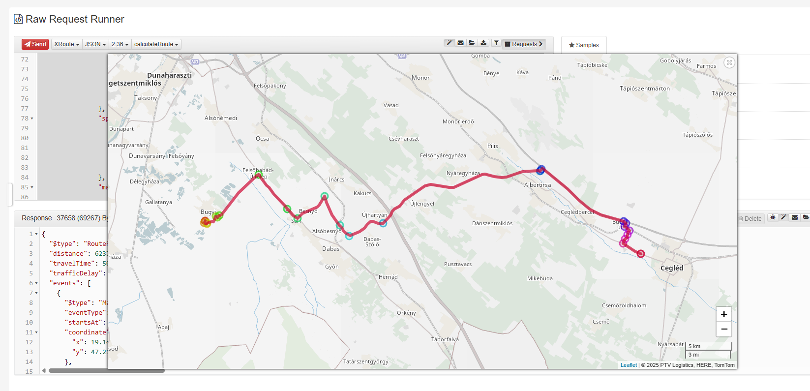

I attached an JSON (in txt file) for the Raw Request Runner.
I do not know yet how to apply your answer in that.

Well, this is what immediately caught my eyes:
  • "distanceTimeWeighting": 100 - causes the engine to look for a very FAST route, even if a detour applies. Probably you should use values between 20 and 80.
  • Code: Select all
    "isDelivery": false
    - means you are not allowed to use "deliveryOnly" segments. Set this value to true and...

On its own, I can easily solve the issue of driving through Dabas in just a moment:
"id": "PTV_TruckAttributes",
"enabled": false
This way, the planner immediately routes through Dabas. Of course, from that point on, it causes serious and unacceptable planning errors along the rest of the route as you described. We’re experimenting too. But this still seems to be a rather difficult problem to solve.
