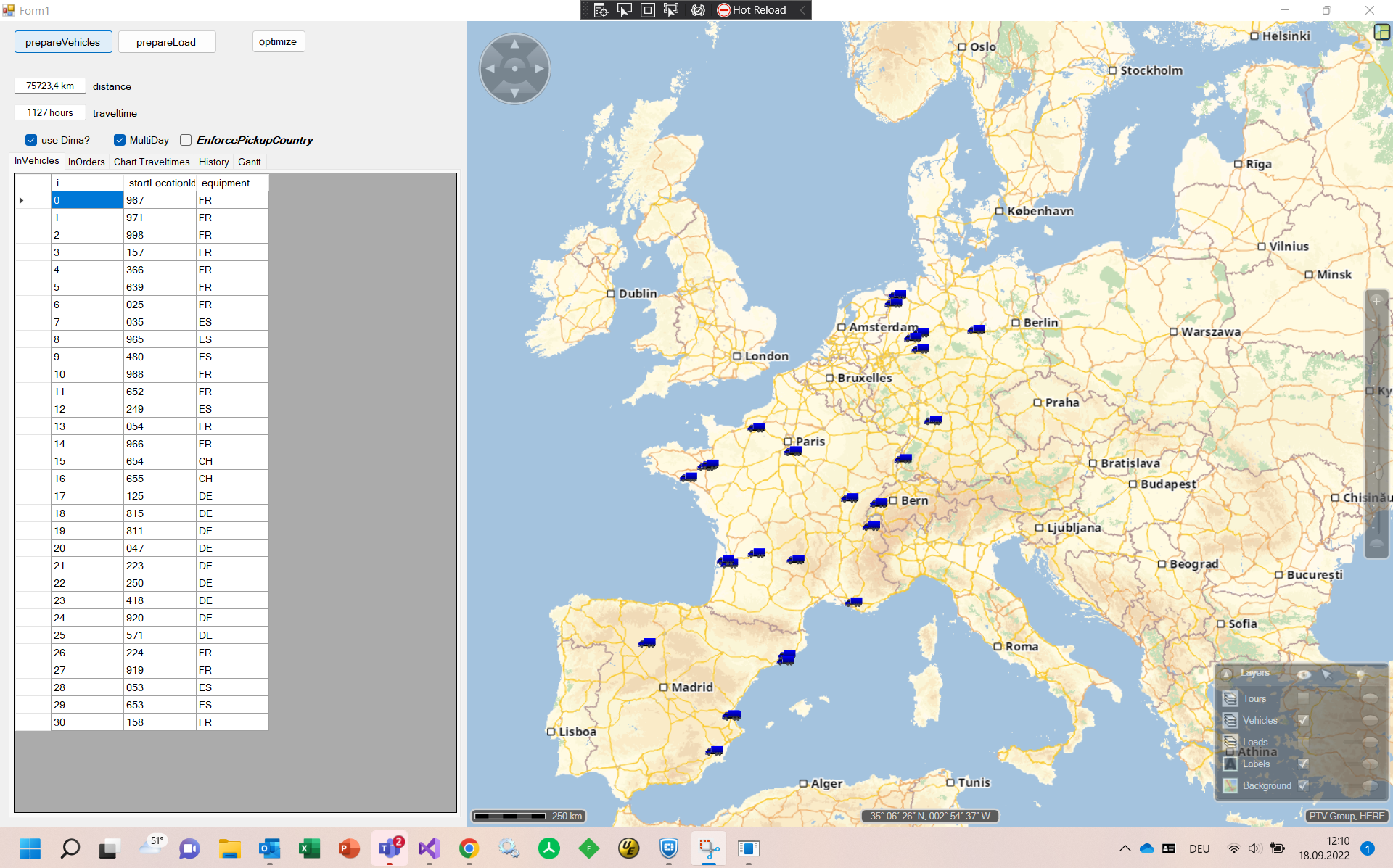

The last positions of a bunch of available FTL vehicles. I also know the country where they remain.

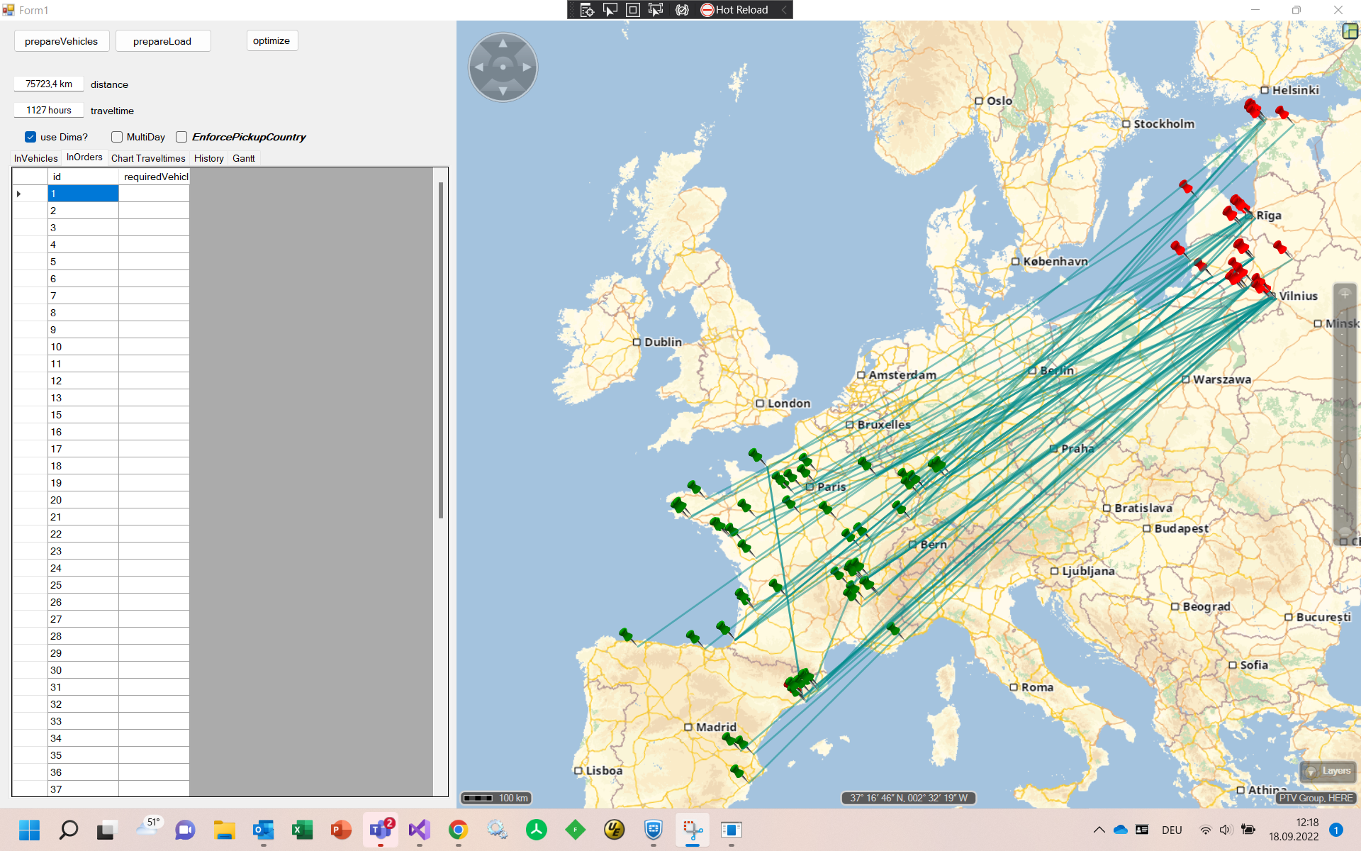

Now the target is this
  • Assign not more than 1 order to each vehicle to create a three stop tour:
    • vehicle position
    • order pickup
    • order delivery
  • Minimize the sum of each vehicles distances

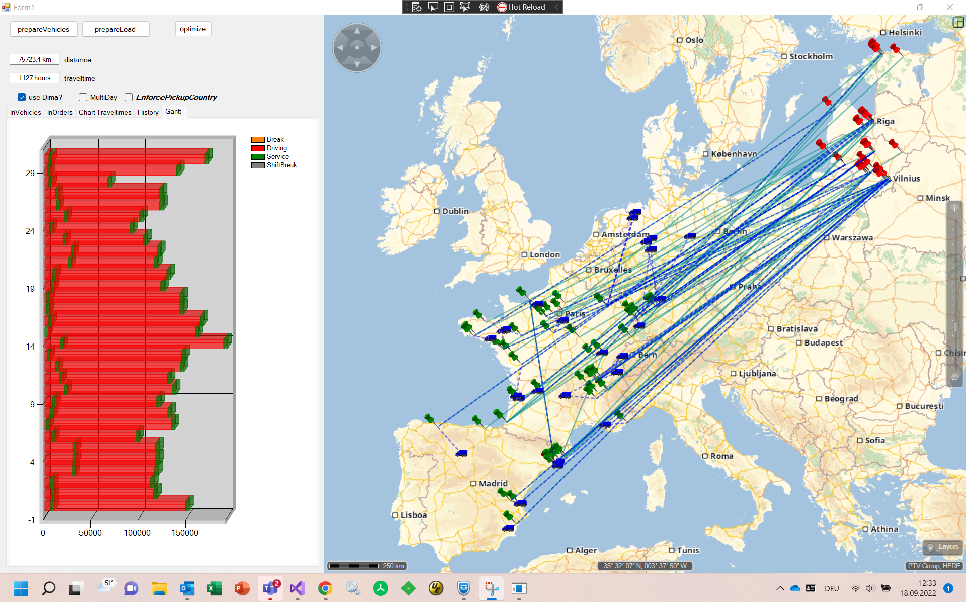

Now here's a first output:
On the left we see the gantt which shows the driving times being split into "vehicle position to pickup" and "pickup to delivery"

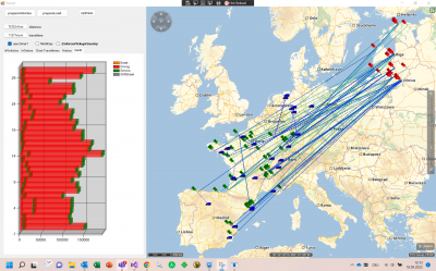

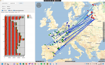

But of course we can add more potential parameters:
Now I also enabled break and rest rules (MultiDays) so we can regognize the interruption of the work because of the grey shift breaks. Important: as the expected tours are long distance tours I is important to allow this: dailyRestPositions = RestPositions.ANYWHERE. If not set the drivers shoudl take their breaks at Depots or at logical position between trips. As each Tour in this case is a single trip this won't work as long as you don't use ANYWHERE.

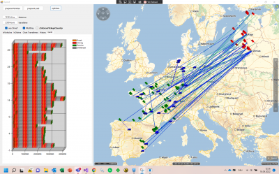

And now we can see that by enforcing the "vehicle position country" has to be equal to "pickup country". This causes some more unscheduled orders. The motivation behind this setting is Cabotage. Though we do not consider cabotage via API it is possible to define a matching between vehicles and orders on a generic level. You can always use the equipment feature for that if you can provide the matching restrictions from outside.
