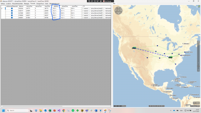

  • Imagine you are returning from a long distance trip with an empty vehicle. At that stage you already know the distance and traveltime of the blue relation based on a distance matrix or 1:1 route. Let's call these KPIs the "reference" for the next steps.

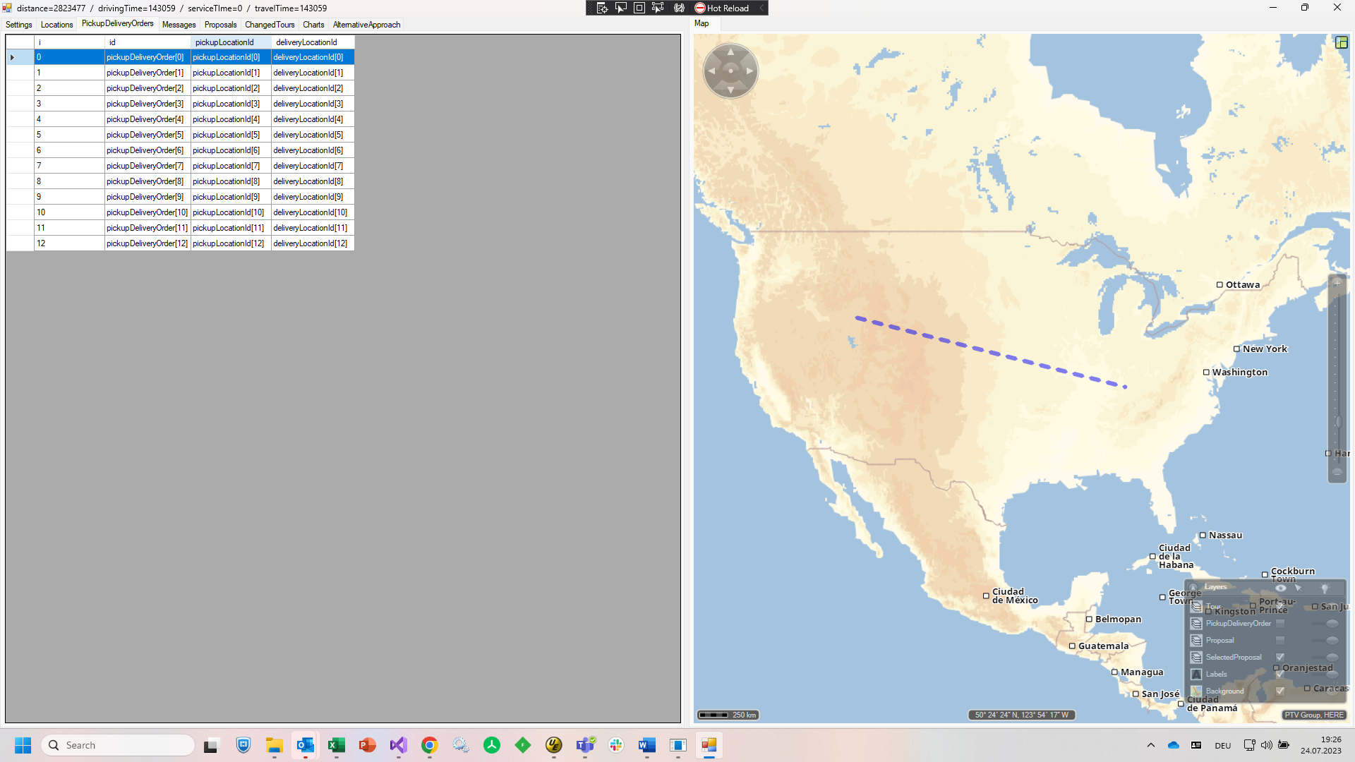

  • Now within your horizon there's a bunch of potential pickup-delivery orders you could go for.
    FTL somewhere around you

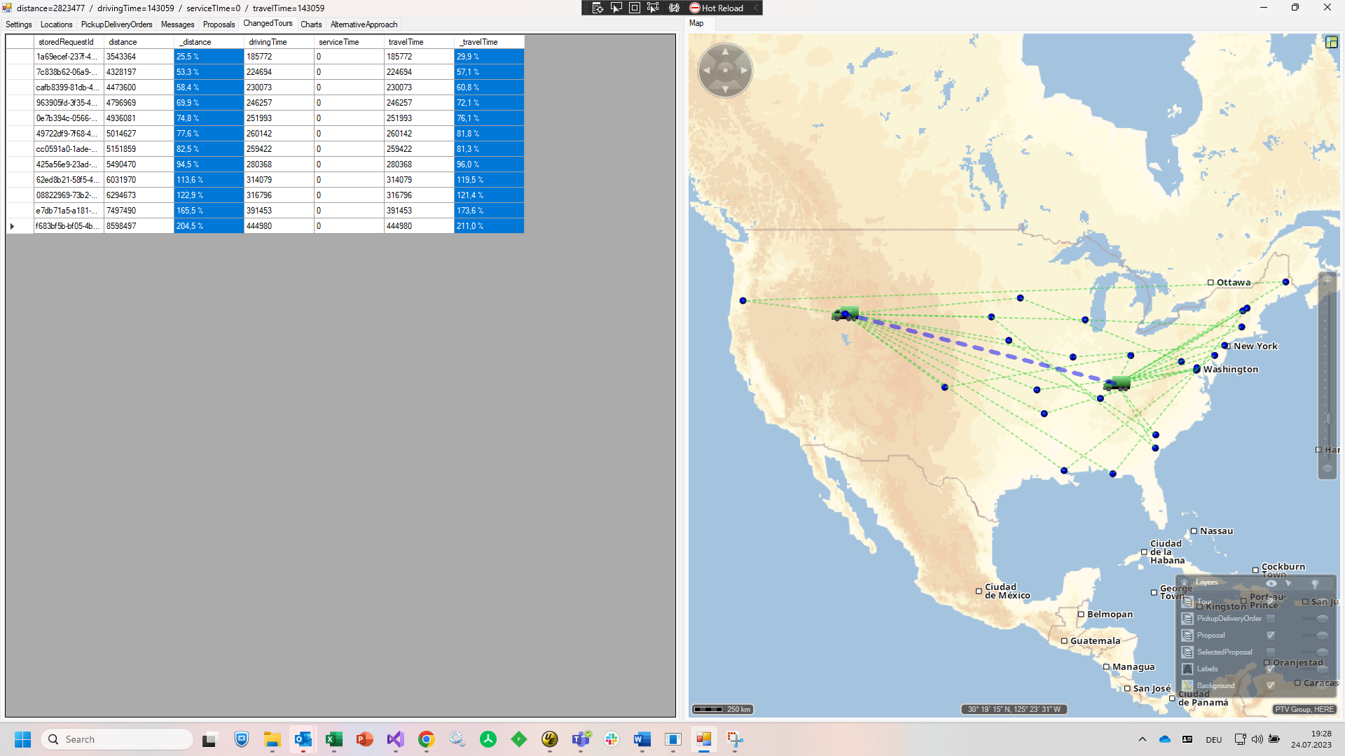

    The output of these calls gives me the decision criteria to compare the impact of the potential "changeToursActions" compared to the "reference" KPIs.
    All potential inserts

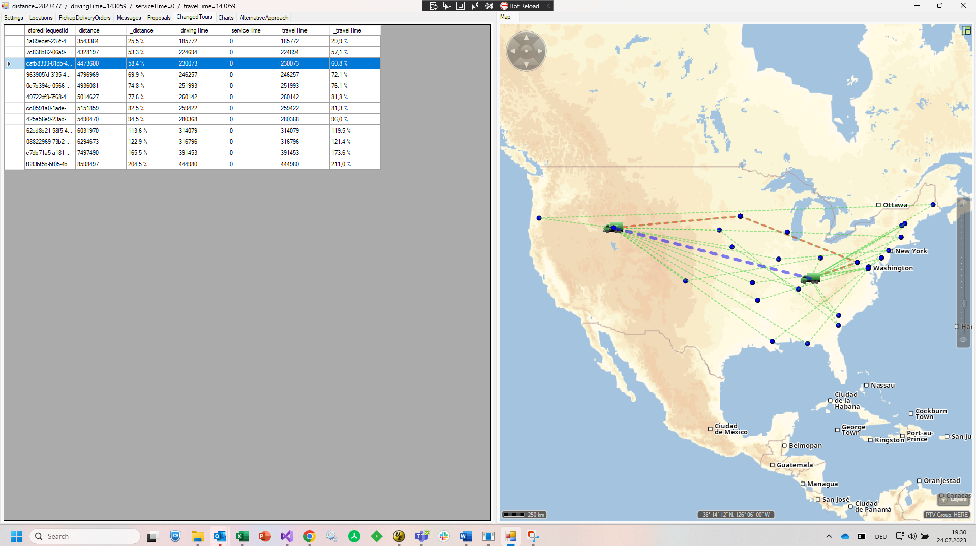

  • I then used the confirmed changeToursActions to compute the complete insertion moves.
    A specific selection

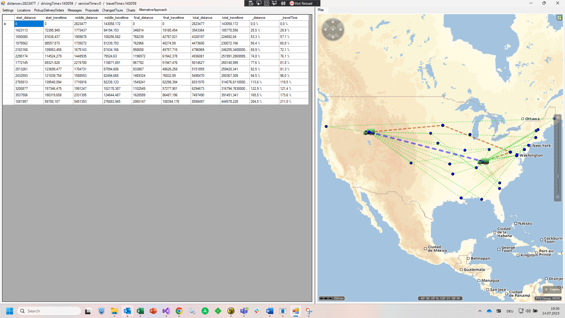

  • For the alternative approach I didn't use the xTour module but a linear growing process based on three contributing factors per candidate:
    • The leg from the global starting location to a candidates pickup
    • the leg from the candidates pickup to the candidates delivery
    • the leg from the candidates delivery to the global delivery.
    So more or less this is based on 3 rectangular matrices:
    • [1:N] : from the global pickup to all candidates pickups
    • N-times [1:1] : from each candidates pickup to its own delivery (this info is supposed to be available once such a candidate is inserted into the global pool!)
    • finally a [N:1] matric from each candidates delivery to the global delivery
    . The output looks pretty much the same compared to the approach above but there's a downsight: you can't apply break- and restrules
    Instead of the complete distance matrix based "tour optimization" you can go for a linear growing approach
  • NO matter what approach you want to go for: it probably makes sense to define some simple filter criteria to not consider changeTours which exceed some threshold value, e.g. based on a relative "increase" of traveltime or distance caused by the detour.
    Client filter based on relative distance... threshold 75%

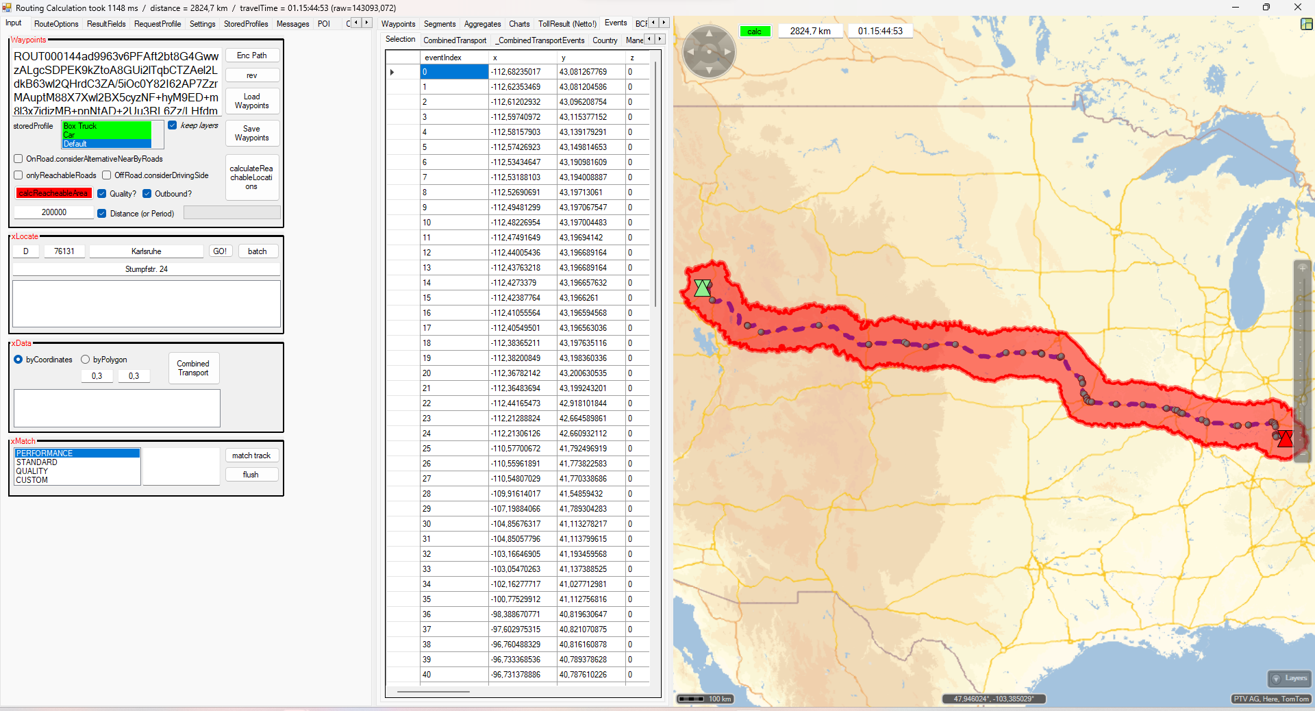

  • Last but not least you could evaluate to define some other criteria in advance which reduces the input candidates for that little process, e.g. based on corridor searches / reachable areas.
    The corridor of 100km along the reoute - helpful for some quick prefiltering "before" the candidates are forwarded to the "expensive" process.
