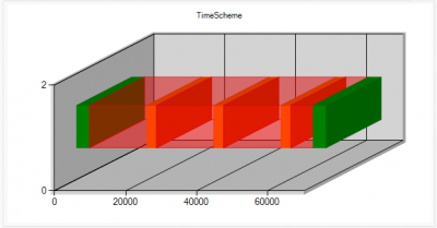

Imagine a driver who is completely refreshed but who needs a break after 4:30 hours.
Forward: based on a refreshed driver in ExactAtStart mode. This structure is what you'd like to get.
With "ExactAtArrival" we would insert the "first" break 4:30 back from the ArrivalTime and so on.
The output route of such an approach would probably display the "early" breaks way too early.

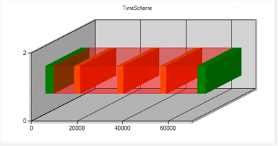

Now in this case I simulated the expected output with an (impossible) combination of "ExactAtArrival" and "Break- and Restrule of a refreshed driver". The first break occurs somewhere after 2:00 hours which is wrong.
