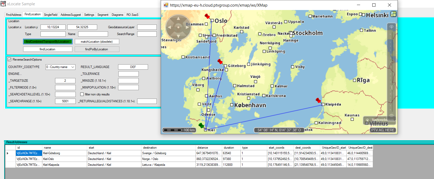

the class "SearchOption" is a base class from which several other classes derive their specific properties. This is visible in this diagram.
You can find som additional info in the additional usecases documentation
That paragraph mentions some meaningful ReverseSearchOptions (Parameters):
  • ENGINE_TOLERANCE
  • ENGINE_TARGETSIZE
  • ENGINE_SEARCHRANGE
  • LANGUAGE_CODE
I hope this helps,
sample screenshot from an xlocate 1 testclient

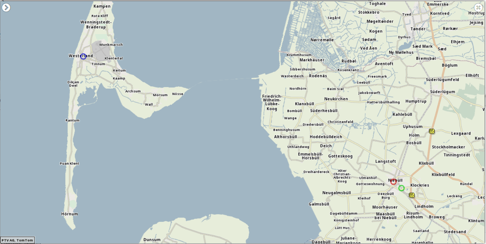

here's a sample that returns a train connection: the Sylt Shuttle from Niebüll
  "location": {
    "coordinate": {
      "point": {
        "x": 8.82716,
        "y": 54.78669
  "options": [
      "$type":"ReverseSearchOption",
      "param":"ENGINE_SEARCHRANGE",
      "value":"7000"
  "callerContext": {
    "properties": [
        "key": "CoordFormat",
        "value": "OG_GEODECIMAL"
So you should be able to locate the train connections without further parameters. The challenge is more to identify whether this is a train or a ferry ;-)
Syltshulttle train connection between NIebüll and Westerland (Sylt)
