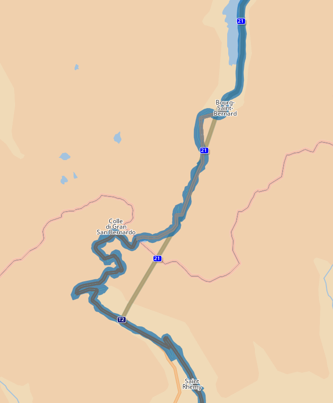

Another remark. If truck attributes are enabled (second request in previous post), the route does not go through St Bernard Tunnel and therefore no toll is calculated:
Posts: 317
Re: xServer 2 - Swiss toll missing
Your axle load is to high. it is set to 11500 and there is a 8000 axle load blocking on the route that goes through the tunnel. Note: although it does not influence this particular route you also have to many axles (5 atm). I would recommend not writing out the entire request profile and just set the storedProfile to "car" in this case.

Many, many thanks for the great help. The axle load was indeed the problem.
