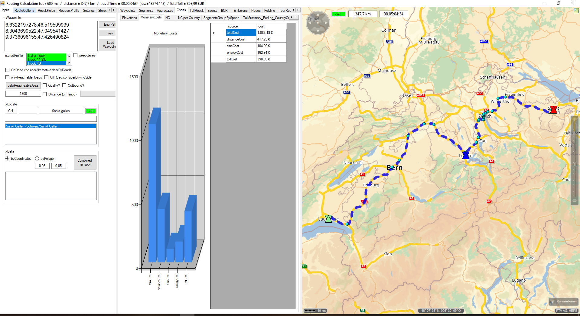

Re: xServer 2 - Swiss toll missing
Hello Andreas,
please provide your complete request to me 1:1 (bernd.welter@ptvgroup.com).
I get toll for SUISSE immediately for my 40t truck profile on xServer Internet 2.
