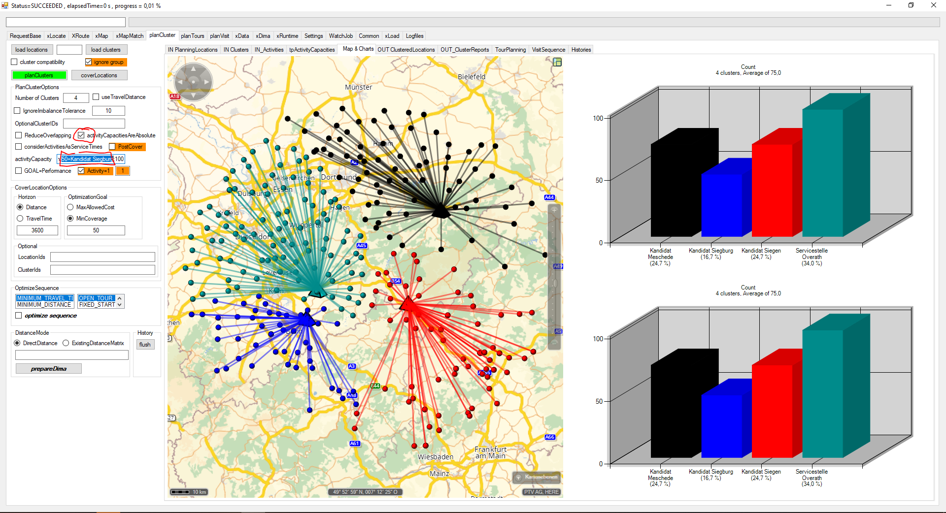

Here's an output example:
In this example I applied an absolut limit of 50 for one of the centers (blue = Siegburg) while the other centers get 1000 (way more than available stops).
No absolute activities defined: all territory centers get more or less the same part (25% of the 300 locations)
