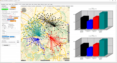

in xCluster 2.20 we invented some PlanClustersOptionsthat approach what your partner requests:
Here's an output example:

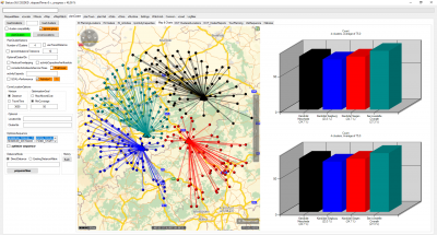

Be aware that the parameter deals with the "activity" and not with the "number of assigned stops". Therefore your requirement can be handeled with setting the locations activity to 1 each.name: activityCapacitiesAreAbsolute
type: Boolean
required: no
default: false
available since: 2.20
This feature can be used only when clusters are specified. If set to true, activity capacities are taken as absolute upper bounds for specified clusters according to their input sequence. The parameter imbalanceTolerance does not play any role. This means, it could happen, that a planning location remains unplanned in the end. Furthermore, it could happen, that a cluster facility is not allocated to any planning location, i.e. the respective ClusterReport.numberOfLocations is zero and the respective ClusteredLocations.locationIds is empty.
