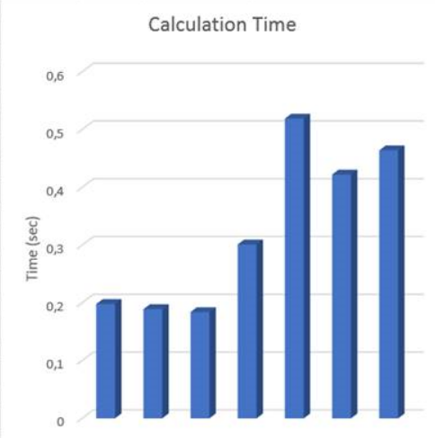

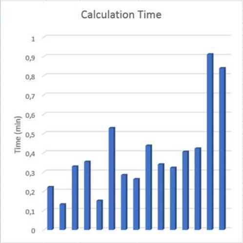

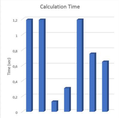

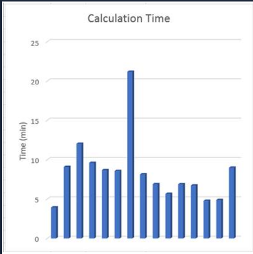

I'm adding this reply to share with you the results of our tests on the HPR using xRoute and xTour, below are some stats we gathered during our tests.
In summary the results are so impressive and drastically better than before
Testing Environment
  • 4 worker xTour
    2 worker xLocate
    2 worker xRoute
    1 worker xMap
    64 GB RAM
    2 profiles dimaTruck and dimaCar
    During the tests we ran (15 requests xTour, 7 requests xRoute, 5 requests xMap, 4 requests xLocate)
Here are the results
- xTour without HPR (calculation time without Queuing)
xTourWithoutHPR
xTourWithoutHPR
- xTour with HPR (calculation time without Queuing)
xTourWithHPR
xTourWithHPR
- xRoute without HPR (calculation time without Queuing)
xRouteWithoutHPR
xRouteWithoutHPR
- xRoute with HPR (calculation time without Queuing)
xRouteWithHPR
xRouteWithHPR
- And here's a summary
summary
summary
Regards
Ibrahim
