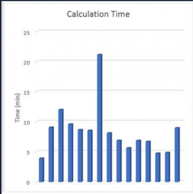

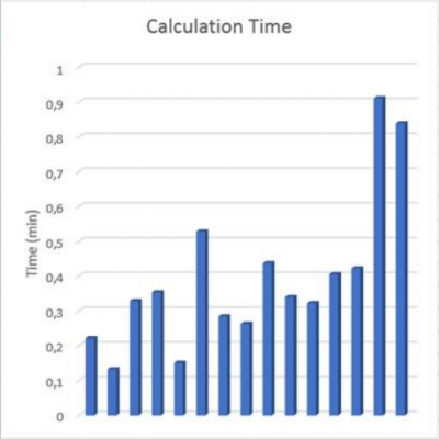

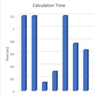

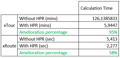

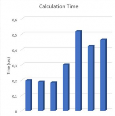

I'm adding this reply to share with you the results of our tests on the HPR using xRoute and xTour, below are some stats we gathered during our tests.
In summary the results are so impressive and drastically better than before
Testing Environment
- xTour without HPR (calculation time without Queuing) - xTour with HPR (calculation time without Queuing) - xRoute without HPR (calculation time without Queuing) - xRoute with HPR (calculation time without Queuing) - And here's a summary Regards
Ibrahim

- 4 worker xTour
2 worker xLocate
2 worker xRoute
1 worker xMap
64 GB RAM
2 profiles dimaTruck and dimaCar
During the tests we ran (15 requests xTour, 7 requests xRoute, 5 requests xMap, 4 requests xLocate)
Ibrahim
