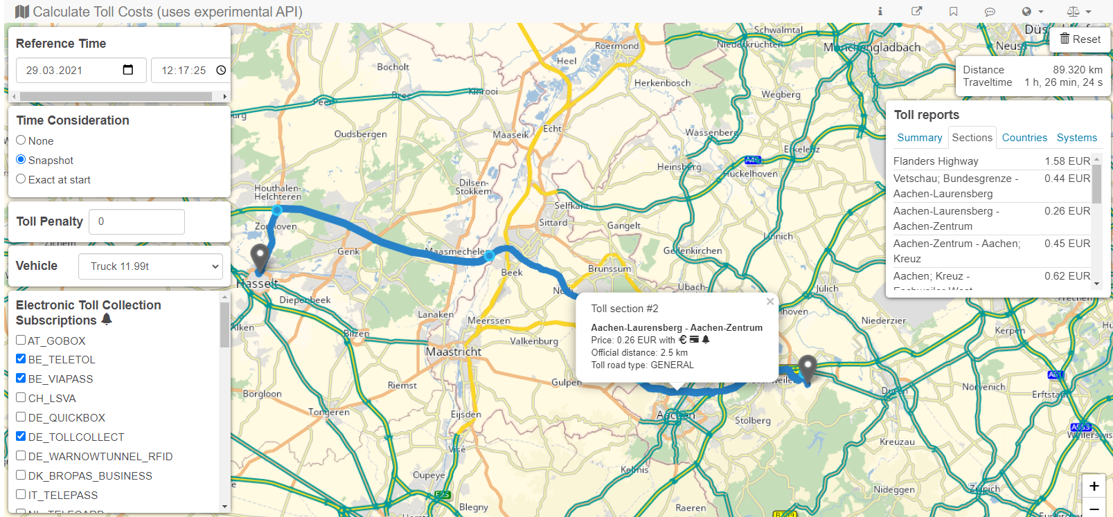

In this article I simply want to let you know about the benefits of this new approach. Here are they:
  • You can now store the toll prices in distance matrices. Besides travel time and distance the toll price is the third dimension.
  • It is possible to calculate the cost optimized route including the toll as part of the target function (doesn't work with old standard toll)
  • You can distinguis between different payment methods (which has an impact on the price itself): Cash, Credic Cart, Electronic (number plate recognition, Subscription)
  • We can support various international payment passes (mainly in the US, but also in many European countries, e.g. AT_GOBOX, DE_TOLLCOLLECT...)
  • Toll is more flexible when it comes to time dependency
  • Toll distances are now reflecting the official toll distances (used to be "estimations" in xRoute1)

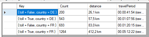

Posts: 3094
Re: Benefits of detailed toll (default toll since v2.22)
Hello Max,
sounds like you are looking for some response elements which are not available so far (v2.22):
- converted costs for toll sections (I expect this for v2.23)
- vignette handling (best case v2.23, but maybe later)
Furthermore it is important to know that the returned officialDistance is not returned for countries where the toll is calculated on estimation (instead of exact toll tables of the providers).
Germany: official distance is gathered from TollCollect data<br />France: distance is estimated based on segment lengths
Distances gathered by segments grouped by toll flag and country
segments Distances.PNG (8.5 KiB) Viewed 96419 times
I'll prepare a sample for you. We should at least look how we can close the gap as good as possible.
