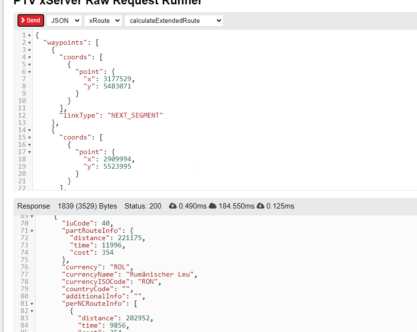

nirengp
Posts: 15
Joined: Wed Jun 28, 2017 12:54 pm
Re: Currency Romanian leu - Romania code ROL
Post by nirengp »
Hello Bernd,
I tried setting countryInfoOptions.currencyDescription=true while calling calculateExtendedRoute().
However, getting currencyISOCode as null in response.
Is their any sample which I can check to see what am I missing for this?
Thanks
Niren Patel
Core Developer
BRABENDER tech
Posts: 2892

nirengp
Posts: 15
Post by nirengp »
Hello Bernd,
I tried setting coutryInfoOptions as per the sample you provided.
Still the currencyISOCode in response is null. Not sure why!!.
Is their any configuration required in PTV xServer. We are using xServer version 1.24.
I will give it one more try, and will get back to you.
Thanks
Niren Patel
Core Developer
BRABENDER tech
nirengp
Posts: 15
Post by nirengp »
Hello Bernd,
It worked. Thanks for the help.
Niren Patel
Core Developer
BRABENDER tech
