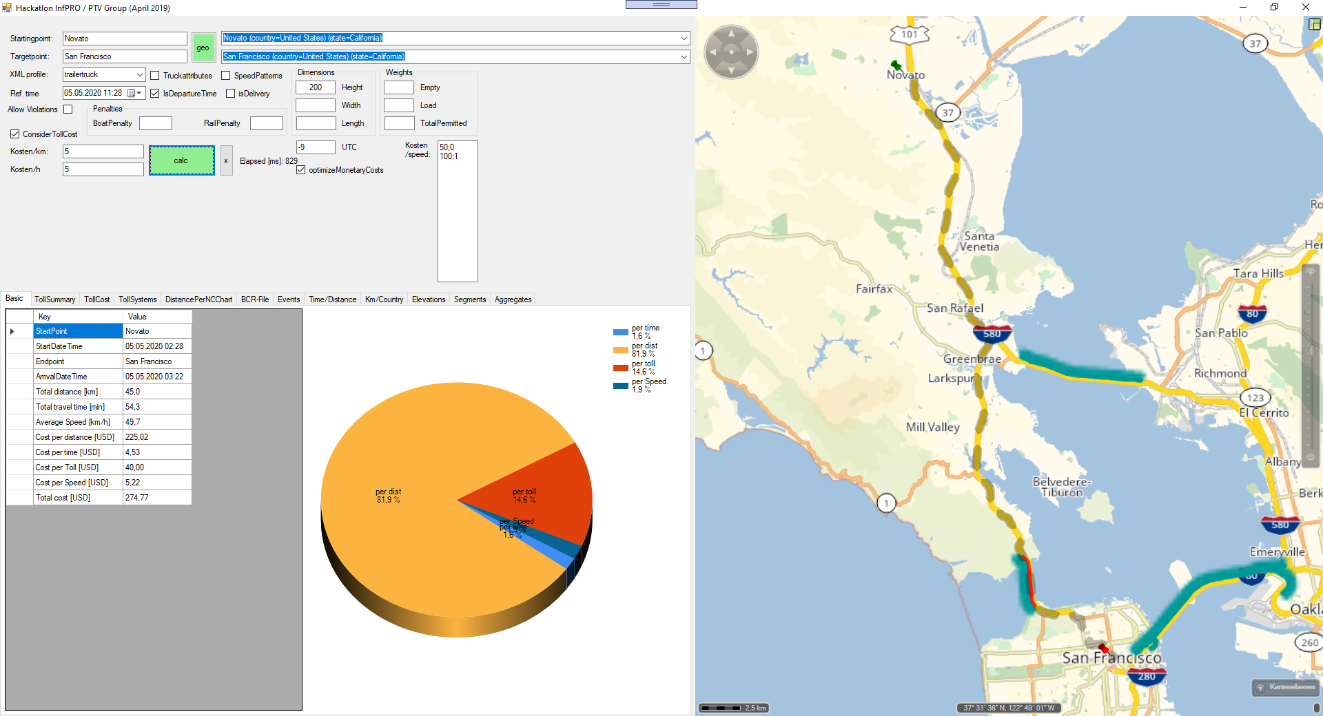

long time ago... here's some info that refers to your original post: within xServer 2 we offer so called Monetary Cost Optimization.
Compared to the traditional routing you can now specify costs/distance and costs/time and further factors. Together with toll costs we will then determine the path that minimizes the total costs of a track. This is an important new approach because In the past we determined the path first and computed the toll costs afterwards. Be aware that the pie charts in the following screenshots display costs relative to the total costs.
Example 1 :  shortest track via Golden Gate bridge: almost no partial costs due to distance, the only relevant block is the bridge toll

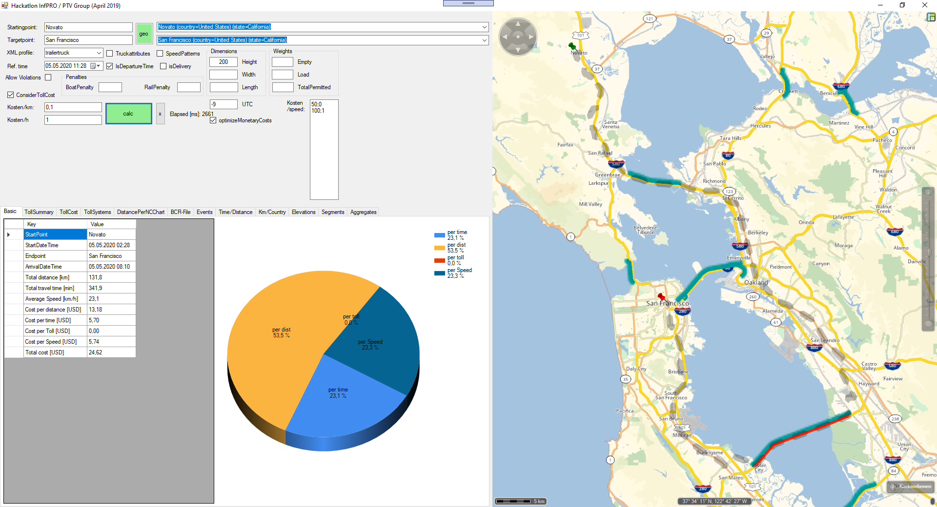

Example 2 : by setting the costs per distance and time to a very low level the track takes a long detour just to avoid any toll costs along the route
