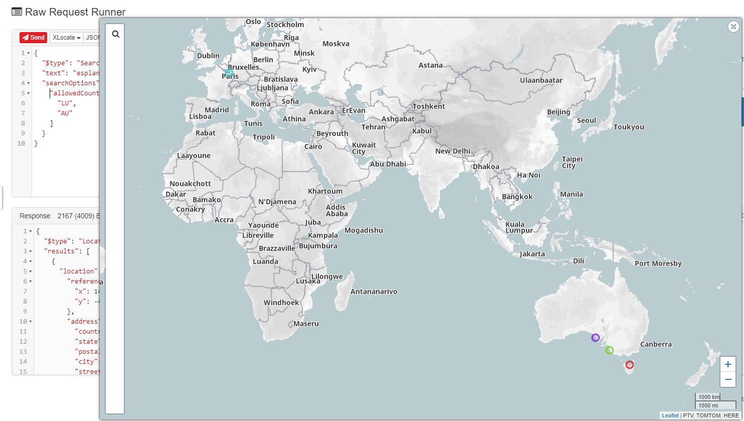

Here's an example output Best regards,

You can test the new feature in the test environment:
https://xserver2-test.cloud.ptvgroup.co ... Runner.htm
Feedback is welcome!
