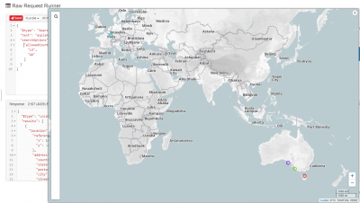

the feature described by Jochen can improve both the quality of a result and also the performance because the data that has to be analyzed is reduced ;-) Customers who are active in a defined part of the world will benefit from this...
Here's an example output
Geocoding of "esplanade 5270". Only hits in LU and AU are searched
