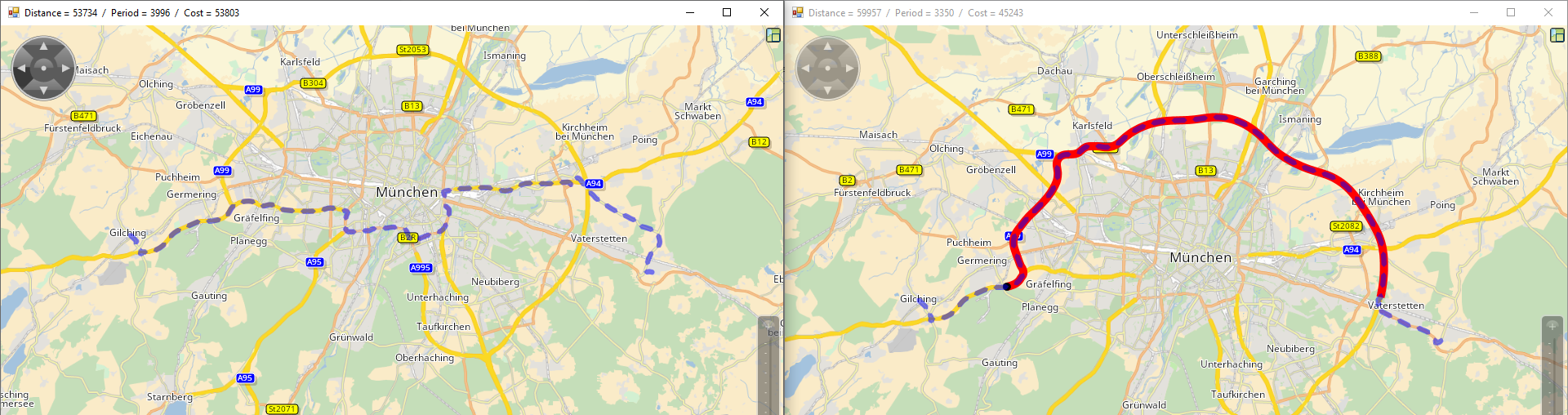

just for those who look or a sample snippet ready to be used with PTV_PreferredRoutes:
Feature Layer PTV_PreferredRoutes is activated on the route in the right map. Therefore the inner city of munich is bypassed. As the red segments are getting a negative malus (causes preference handling) the costs of the right route is cheaper than without the layer. I used https://xroute-tln-eu-n-test.cloud.ptvgroup.com/ for the comparison. Also important: The area of Munich is covered by PreferredRouteType=18. Other regions could use other types.
Be aware that PTV_PreferredRoutes is available only for some maps.

The preferredRouteBonus is a regular malus value:
  • negative values between -99 and -1 will decrease the virtual costs of the corresponding route segments which causes them to be more attractive
  • We can't give a definitive recommendation for the value that fits your requirements best - that's something you have to play with ;-)
  • The preferredRouteType describes the character of a segment, e.g. category 18 means "Local route network that is designated for trucks with an origin and destination within a borough."
