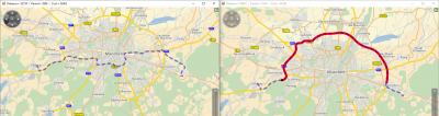

just for those who look or a sample snippet ready to be used with PTV_PreferredRoutes:
Feature Layer PTV_PreferredRoutes is activated on the route in the right map. Therefore the inner city of munich is bypassed. As the red segments are getting a negative malus (causes preference handling) the costs of the right route is cheaper than without the layer. I used https://xroute-tln-eu-n-test.cloud.ptvgroup.com/ for the comparison. Also important: The area of Munich is covered by PreferredRouteType=18. Other regions could use other types.
Be aware that PTV_PreferredRoutes is available only for some maps.

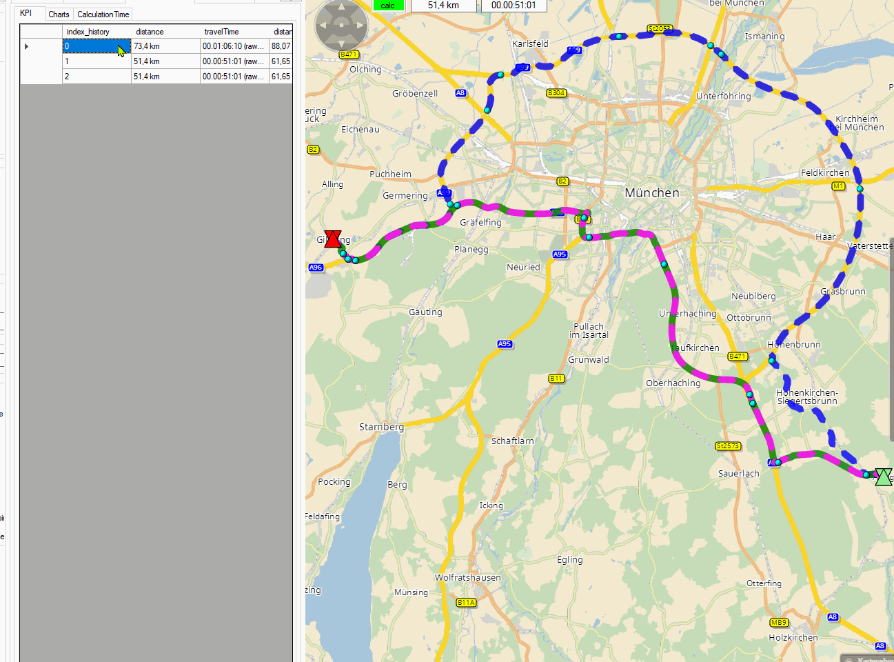

Here's just another visualization of the different routing alternatives. It also shows some KPIs of the routes.
Just another example (München)  -  click the pic, it is animated
