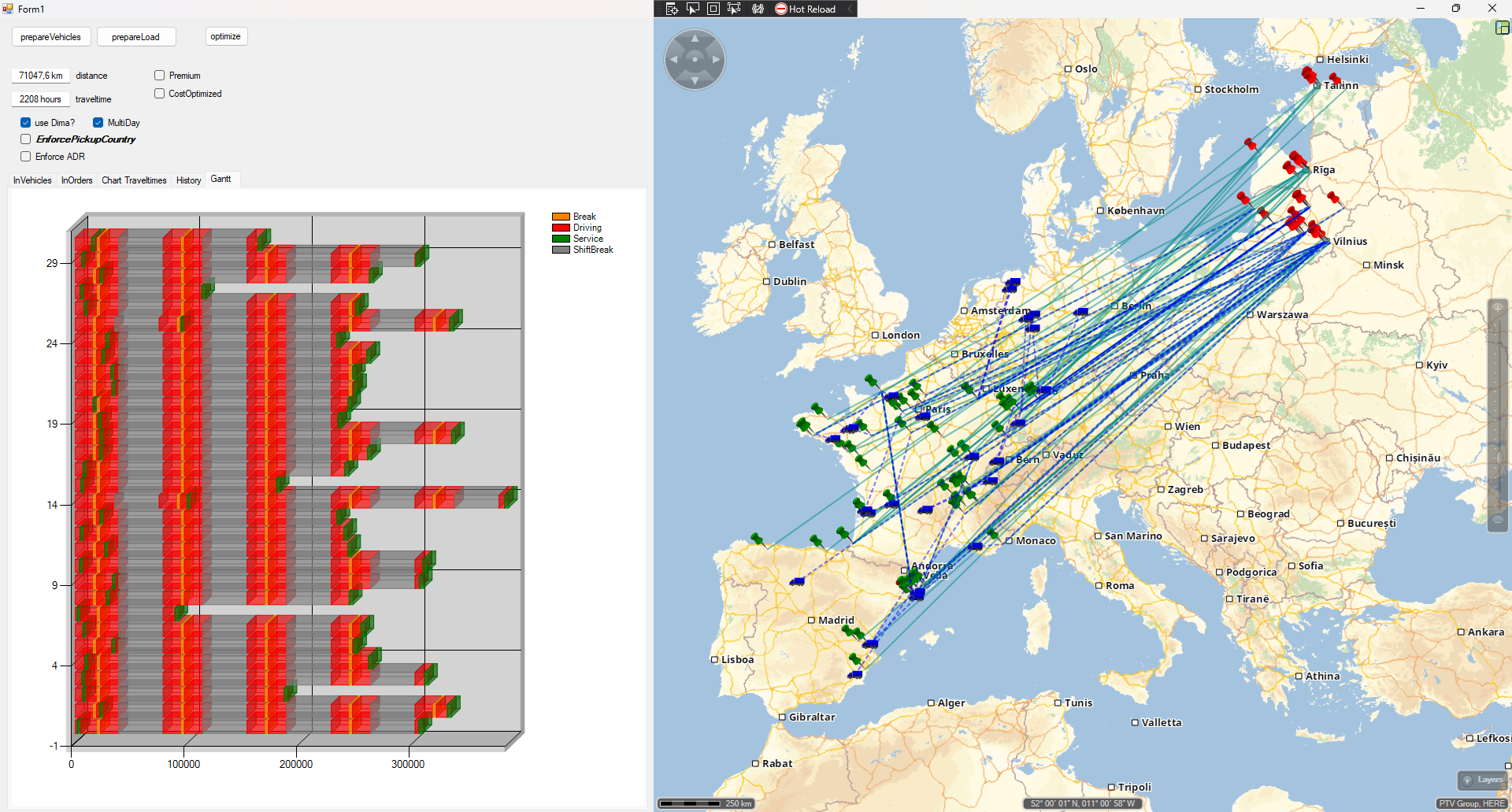

Posts: 3085
Re: UseCase: Optimisation question
Here's a screenshopt from a test client I built for that story. I labelled it "xLotocki". Let me know if we should look into this together.
blue trucks: known last (x,y) of the fleet<br />pins: available transport orders (green=pickup, red=delivery)
