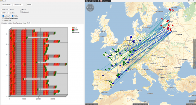

- Posts: 3036
Re: UseCase: Optimisation question
Here's a screenshopt from a test client I built for that story. I labelled it "xLotocki". Let me know if we should look into this together.
