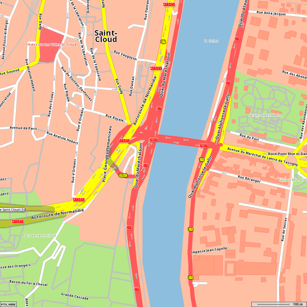

By the way, can you give me the json/soap query you used to get the xmap 1 image in Saint Cloud ?
I've tried this query with the url http://xserver-1:50000/ :

but I get only the buildings on one side. I'm wondering if some extra map data are needed...
xmap1:buildings only on one side

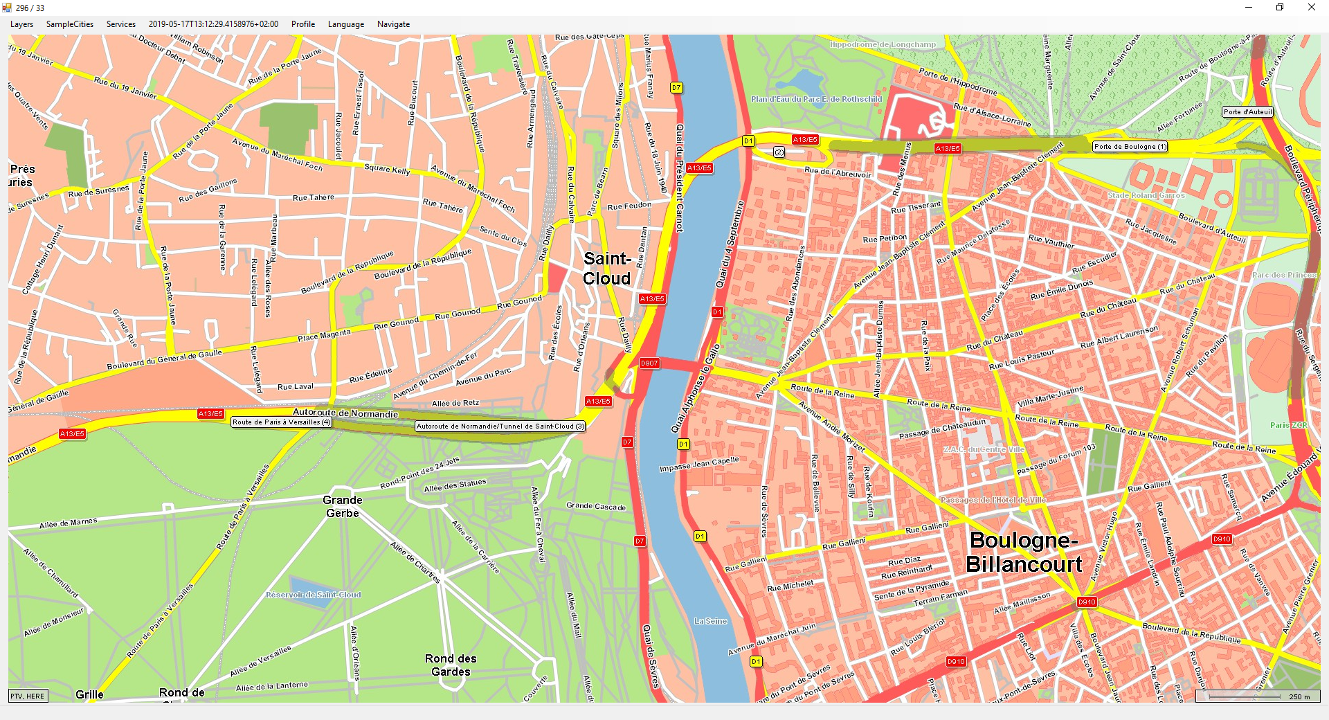

Hello Loic,
TOMTOM / https://xmap-eu-n.cloud.ptvgroup.com/
HERE / https://xmap-tln-eu-n.cloud.ptvgroup.com/
you can't ... in the HERE map the buildings are missing :evil:
loic.caouen
Posts: 8
Joined: Mon Dec 17, 2018 3:37 pm
Re: xMap : display buildings
Post by loic.caouen »
Ok, so we must use TomTom if we want the buildings.
