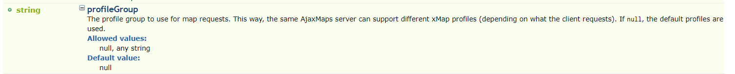

- xMap 1 / Leaflet: https://svc-eu-n-test.cloud.ptvgroup.co ... files/view
- xMap 1 / Ajaxmaps: check the profileGroup mechanism (requires server profiles you can refer to via map.profileGroup)

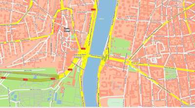

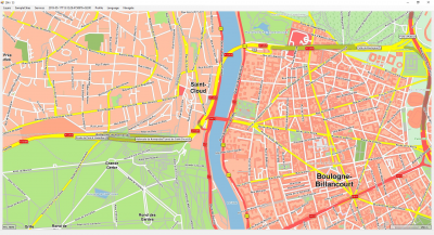

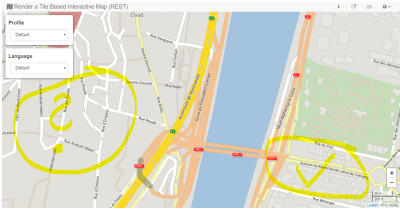

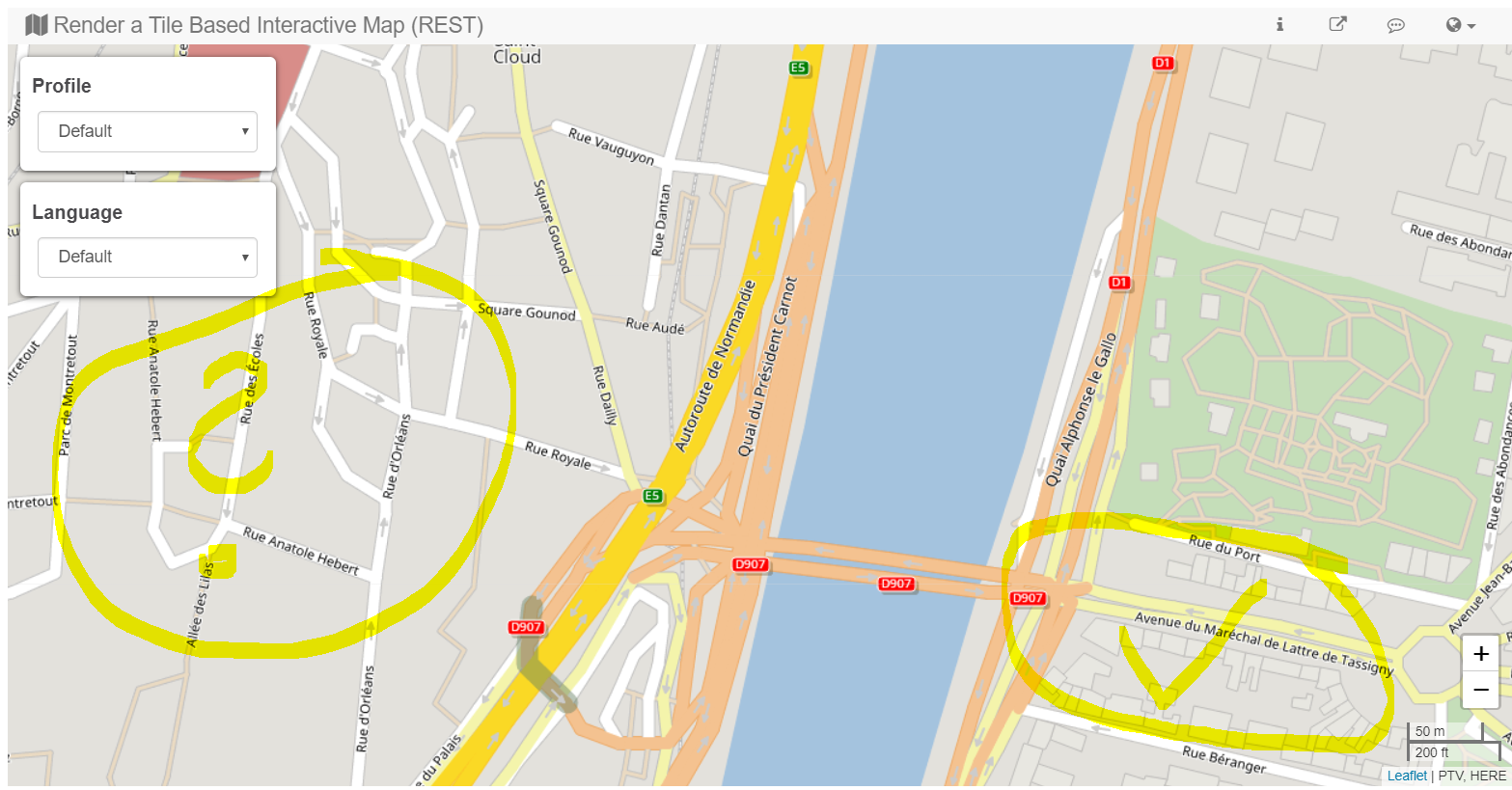

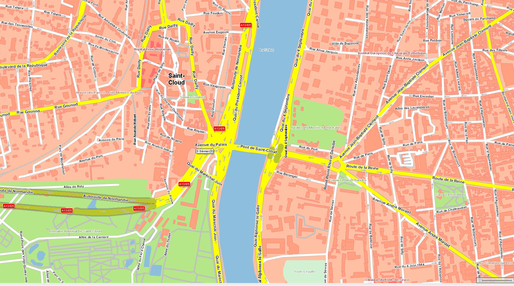

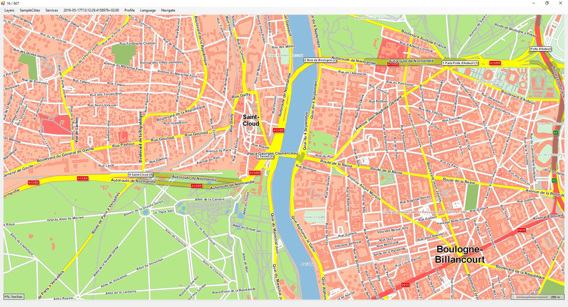

By the way, can you give me the json/soap query you used to get the xmap 1 image in Saint Cloud ?
I've tried this query with the url http://xserver-1:50000/ :
but I get only the buildings on one side. I'm wondering if some extra map data are needed...

- Posts: 3026
Re: xMap : display buildings
Hello Loic,
you can't ... in the HERE map the buildings are missing

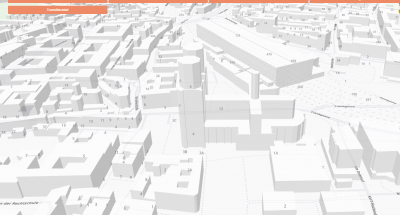

just a sidenote:
nowadays the latest version of PTV Developer APIs now also offers Vector Maps including
- HERE building footprints
- Tilting of maps
- Rotation of maps
