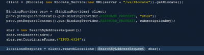

after 3 moths i tried the application again and i got a 301 statuscode for searchLocation method in my javaclient.
I´m using the same server as always: "https://xserver2-europe-eu-test.cloud.p ... m/services" and the code also didnt change.
The picture shows the code piece with the searchLocations method.
I dont know what happened in the past months, anything changed?

Re: searchLocations http statuscode 301
The code worked 3 months ago and now without any changes in my code i get this.
My code is also similar to the examples fromJava example
The complete url is : "https://xserver2-europe-eu-test.cloud.p ... ws/XLocate"
How can i change this into a post request?
Here's another statement from DEV. Not the solution but I'll stay attached to this topic:
The problem is caused by the "http" protocol that is currently specified in the WSDL; java clients download the WSDL and continue requests with the URL stored in the WSDL; this way, the requests is send via HTTP resulting in the 301.
Hello together,
here's a workaround for the issue - works like a charm:
try to explicity set the endpoint address. The following sample worked for me, last line is the fix:
Thanks to Frank for the hint,
String url = "https://xserver2-europe-eu-test.cloud.ptvgroup.com/services/ws/XLocate";
XLocate client = (XLocate) new XLocate_Service(new URL(url)).getXlocate();
BindingProvider prov = (BindingProvider)client;
prov.getRequestContext().put(BindingProvider.USERNAME_PROPERTY, "xtok"); prov.getRequestContext().put(BindingProvider.PASSWORD_PROPERTY, "replace-this-with-your-token");
prov.getRequestContext().put(BindingProvider.ENDPOINT_ADDRESS_PROPERTY, url);
