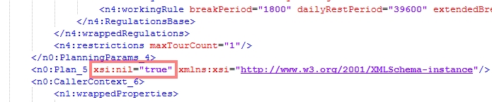

I came across a similar problem using xTour-planBasicTours, where all of the "top" attributes are mandatory, but I did not want to use a input plan.
The deep attributes are mapped into structures in SAP, with each structure containing its fields as well as a table "CONTROLLER". We can use the controller tab to force a xsi:nil-Element in the XML. The following code must be executed before sending the request .
DATA: lt_prxctrltab           TYPE prxctrltab,
          ls_prxctrltab           LIKE LINE OF lt_prxctrltab,
          lo_payload_protocol     TYPE REF TO if_wsprotocol_payload.
    IF ls_request-plan_basic_tours-plan_5 IS INITIAL.
      "fill controller table
      ls_prxctrltab-field = 'PLAN_5'.
      ls_prxctrltab-value = sai_ctrl_nil.
      APPEND ls_prxctrltab TO lt_prxctrltab.
      ls_request-plan_basic_tours-controller = lt_prxctrltab.
      "enable extended XML handling
      lo_payload_protocol ?= lo_proxy->get_protocol( if_wsprotocol=>payload ).
      lo_payload_protocol->set_extended_xml_handling( abap_true ).
    ENDIF.
This adds a xsi:nil attribute to the node, and so it forces SAP to create the node.
There are two other possible values (sai_ctrl_initial and sai_ctrl_none) but I don' have experiences with them. sai_ctrl_nil worked for me.
Maybe this helps.
Frederik
