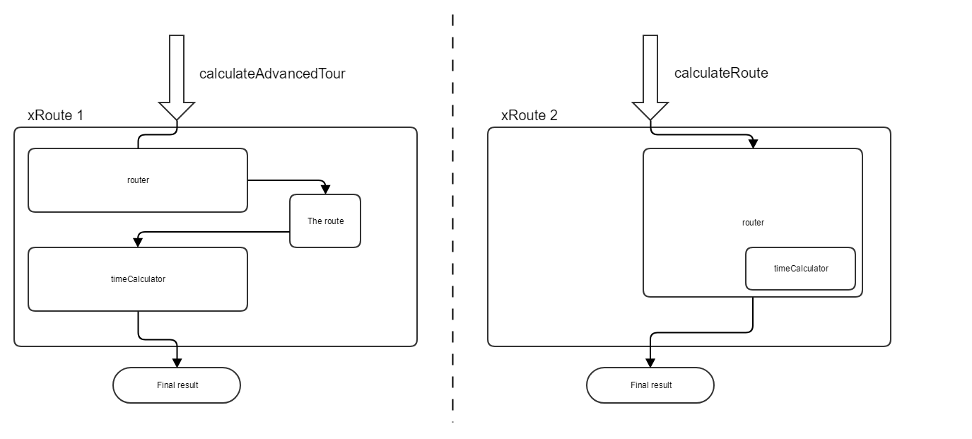

Posts: 3033
Re: Speedpatterns in calculate(Advanced)Tour
Hello Volker,
the attached image shows the difference in the approaches of xRoute 1 and 2 when it comes to time calculation.
Comparison xRoute1 and xRoute2
