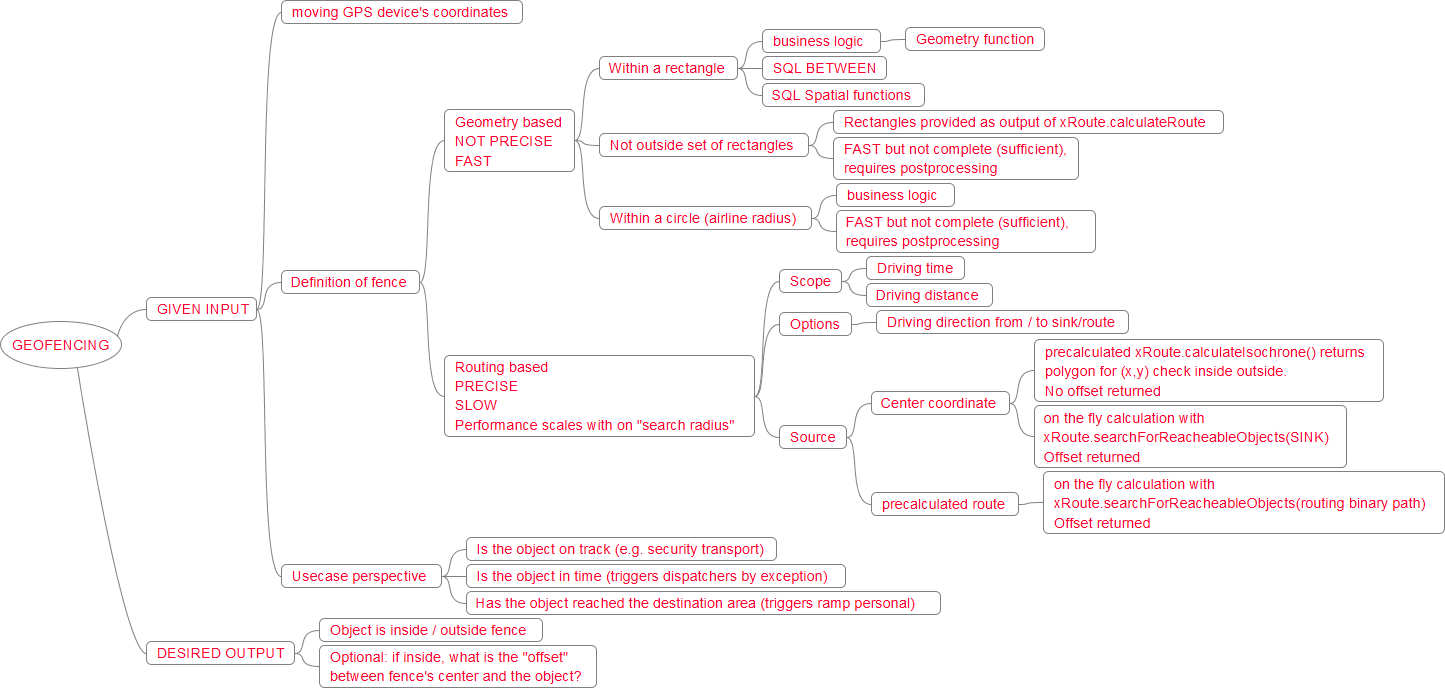

Hi Andreas,
there are a lot of usecases (=requirements) and corresponding approaches given in this simple term.
regular API doc xServer 1.
I created a quick mindmap that should open your mind (
https://www.youtube.com/watch?v=TPFAYIr8z2I ) and lead you to your target.
What is the precise expectation towards the buzzword?
What information would be needed from our interfaces?
If you want we can record a websession about these approaches and I drill through the complete mindmap together with you. Or we identify just the path you need.

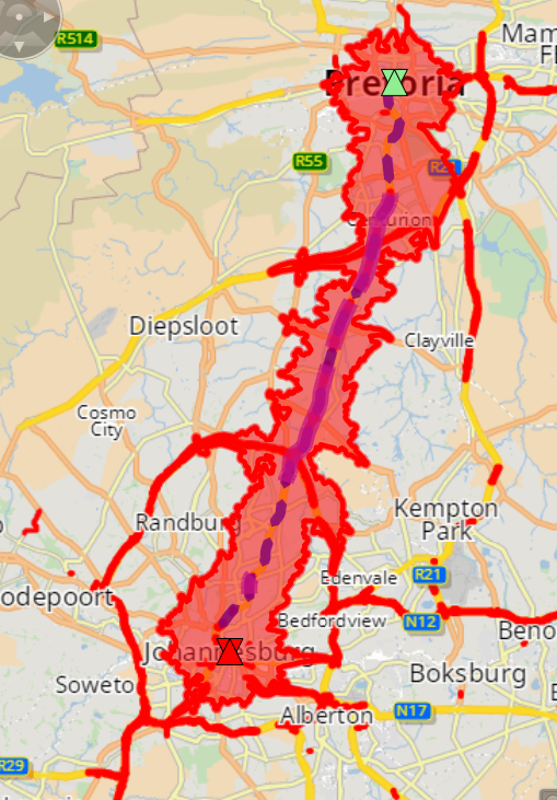

Just have been asked for this again in 2024:
Here’s my feedback, based on PTV xServer2 (please let’s always mention the API version):They would like to plan a route for a vehicle and take into consideration truck attributes on the route with the height width as well as allowed driver hours into consideration. Once the route is planned, they would like to post/send that specific route to navigator, and then generate alerts once the driver goes off route in their platform.
- What’s the exact definition of “the driver goes off route”? E.g. requires more than 10min to return to the route
- You can first compute the regular route polyline / binaryPath through com.ptvgroup.xserver.xroute.RouteRequest including the com.ptvgroup.xserver.xroute.ResultFields.encodedPath
- Then you determine wether the GPS position is within the fence area through com.ptvgroup.xserver.xroute.ReachableLocationsRequest
- With each recorded GPS position that is pushed to the backend you could evaluate “Is GPS position inside the fence? If not inside then alert!”
- Maximum route length = 500km (total route could be split in chunks based on partial trips given by the Break and Rest events)
- Such fencing is not the same as “he won’t be in time” as it only checks inside/outside but not “in time”
- 10min fence on the path from Pretoria to Johannesburg
