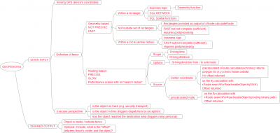

there are a lot of usecases (=requirements) and corresponding approaches given in this simple term.
regular API doc xServer 1.
I created a quick mindmap that should open your mind ( :lol: https://www.youtube.com/watch?v=TPFAYIr8z2I ) and lead you to your target.
What is the precise expectation towards the buzzword?
What information would be needed from our interfaces?
If you want we can record a websession about these approaches and I drill through the complete mindmap together with you. Or we identify just the path you need.

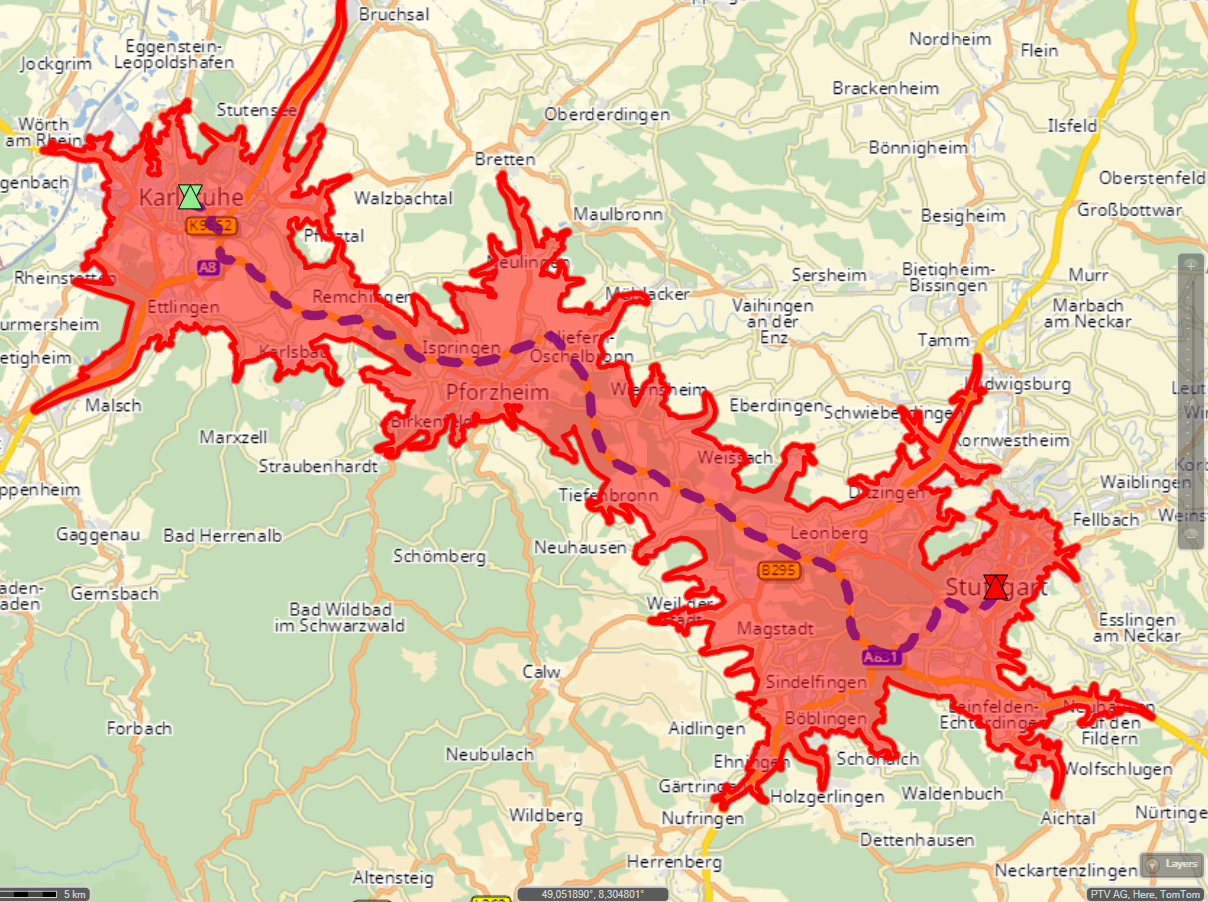

As of today the implementation of xRoute 2 does not yet offer the corridor search but there's also another approach to perform the routing based fencing - a least as a temporary solution if the corridor is small:
- Compute the reacheable area(aka Isochrone) around the latest GPS coordinate
- Check via geometry functions whether polygon and isochrine intersect
several position's isochrones have been checked against the route...
But I am very optimistic that we will implement and proivide a corridor search in the xServer 2 ;-)
