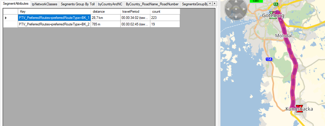

the web page you sent us in the last post is our old website. This website normally redirects towards ptvgroup.com. You must have found a sub page via google.
Yes we can handle BK classes also with xServer. Check the feature layer PTV_PreferredRoutes (HERE: available in 2020.2H / TOMTOM: not available so far).
These BK classes are unique for Sweden and they define restrictions for heavy vehicles. possible in xRoute or to visualize them in xMap.
The followiong screenshot was made with the Showcase: And here's a screenshot from my local client Best regards,
PS: Thanks to Mikkael and Thorsten for their contribution!

this needs three steps:
- the feature layer data is required in the server's map folder
- you need a license that allows you to use the PTV_PreferredRoutes
- you need to activate that layer in the mapping / routing requests
