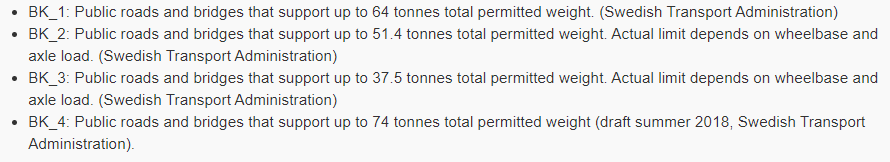

Here's some more valuable info and a fancy video:
The swedish network classes are described as follows in the documentation of the prefered routes feature layer:
Screenshot from the docu

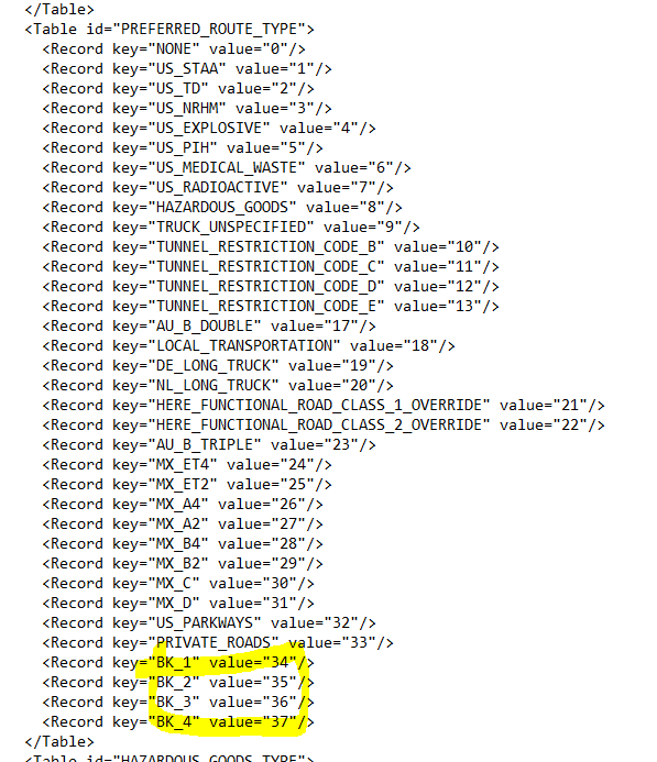

Unfortunately the rendering profiles do not expect these labels such as BK_1 but specific integers and of course the next question is: where to find the matching between such a label and the integer?
Technically spoken the definition of these values is given in the so-called property connector files within the map. Here's an example from my local installation:
Excerpt from my local propertyConnectorV014.xml (in the map folder)
:!: I can't guarantee that the integer values are stable - they might change from map version to map version!

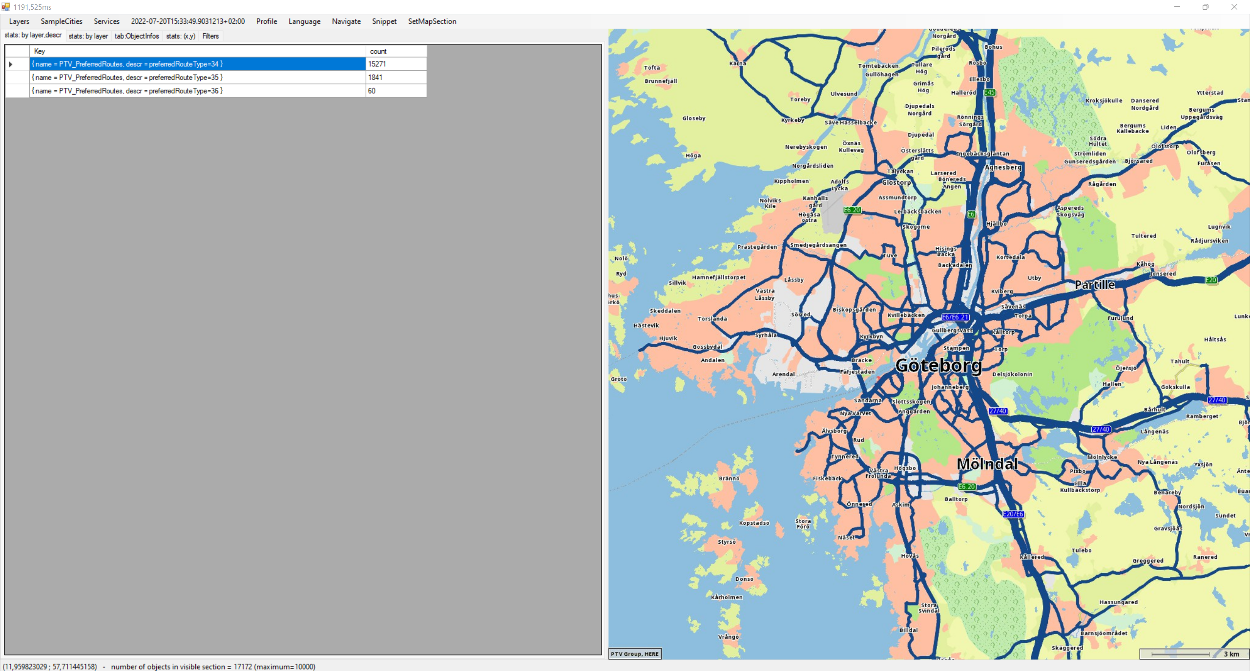

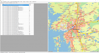

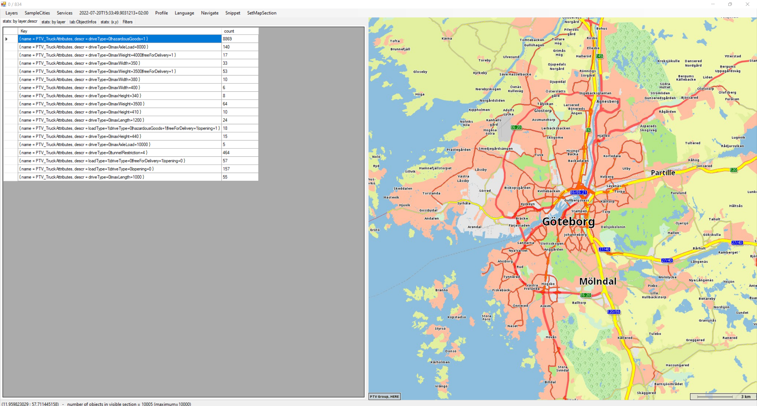

Here's a short update... the attached screenshots show the coverage of PTV_TruckAttributes and PTV_PreferredRoutes in the 2022.2 maps of TOMTOM and HERE in the region of Gothenburg/Sweden.
Here are the numbers for the visualized areas (not for the map as a whole!)
ProviderPreferredRoutesTruckAttributes
2022.2T016'826
2022.2H17'17210'005
So TOMTOM provides the "preferred" data in the "truck attributes":
While you are able to specify the PTV_PreferredRoutes (plus the road classes such as Swedish BK_1, ...) with a proper malus in the HERE map you need to choose a different path in the TOMTOM world: make sure that you request PTV_TruckAttributes together with proper vehicle settings.
HERE<br />PTV_TruckATtributes 2022.2H
HERE
HERE<br />PTV_PreferredRoutes 2022.2H
HERE
TOMTOM <br />PTV_PreferredRoutes 2022.2T
TOMTOM
TOMTOM <br />PTV_TruckAttributes 2022.2T
TOMTOM
