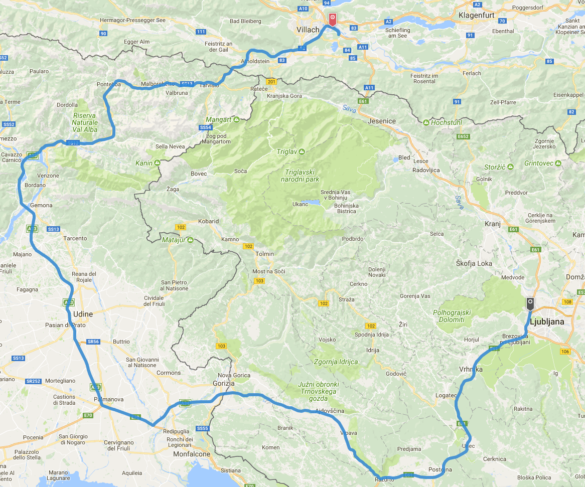

after some more thorough testing, I've noticed that I am still getting some strange results.
For PTV Map&Guide calculations, I used the RF truck 40t (truck40t_02-00_M) profile.

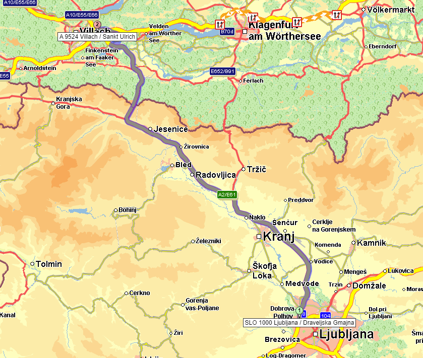

Example 1:
Ljubljana (SLO) -> Villach (AUT)
PTV Map&Guide:
Mine:
For some reason, the calculated route avoids the Karawanks Tunnel.
If I change the start point closer to the tunnel, then the route leads through it. Both of the calculated routes have 0 violations specified.

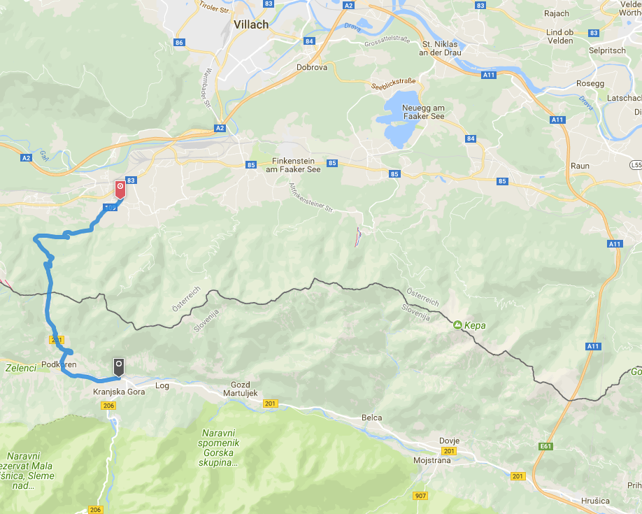

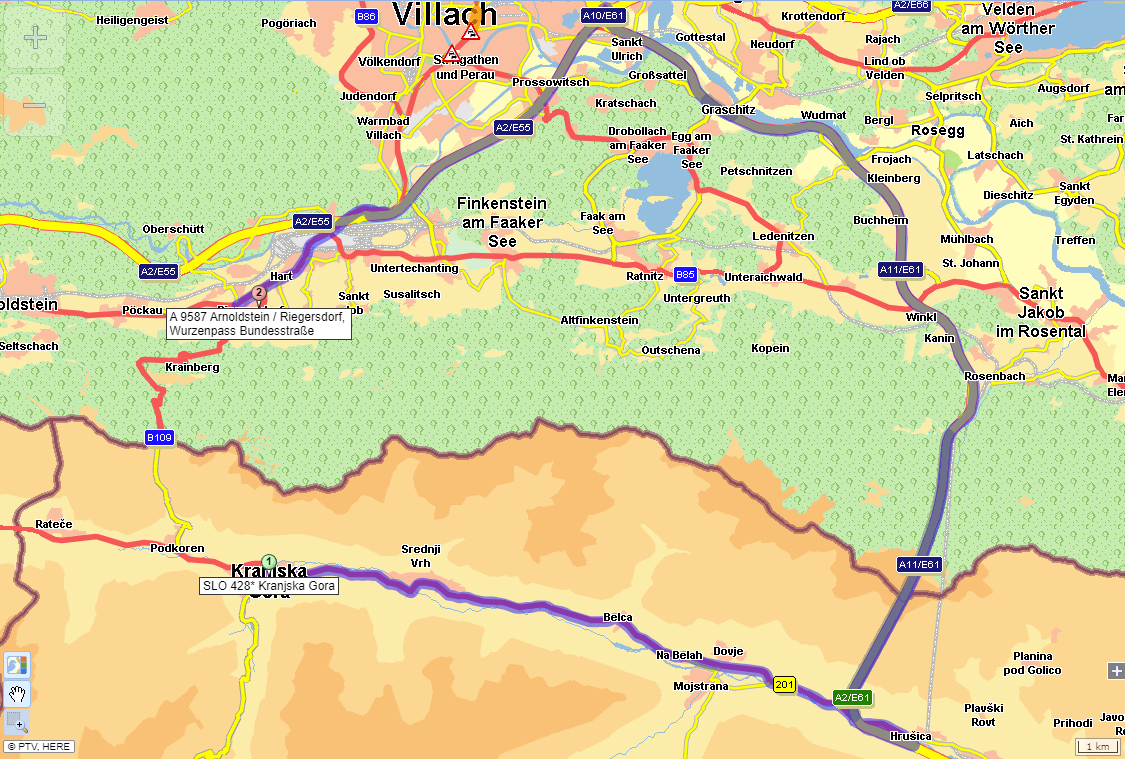

Example 2:
Kranjska gora (SLO) -> Riegersdorf (AUT)
I have used this example in the first post, I forgot to test it right after I changed the vehicle parameters.
PTV Map&Guide:
The calculated route avoids the road, which is the correct behaviour, because the road is blocked for vehicles with a trailer.
Mine:
Calculated route goes straight through the blocked road. No violations have been specified.

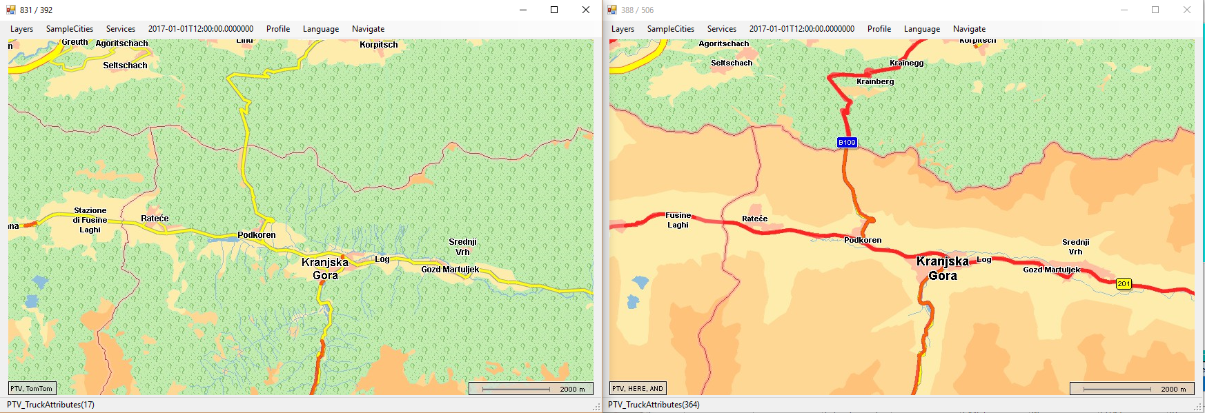

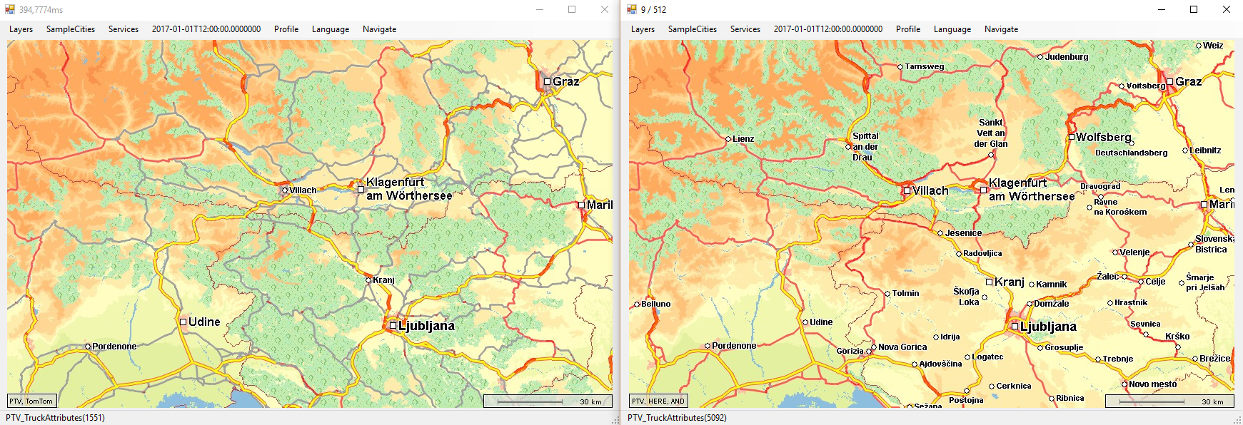

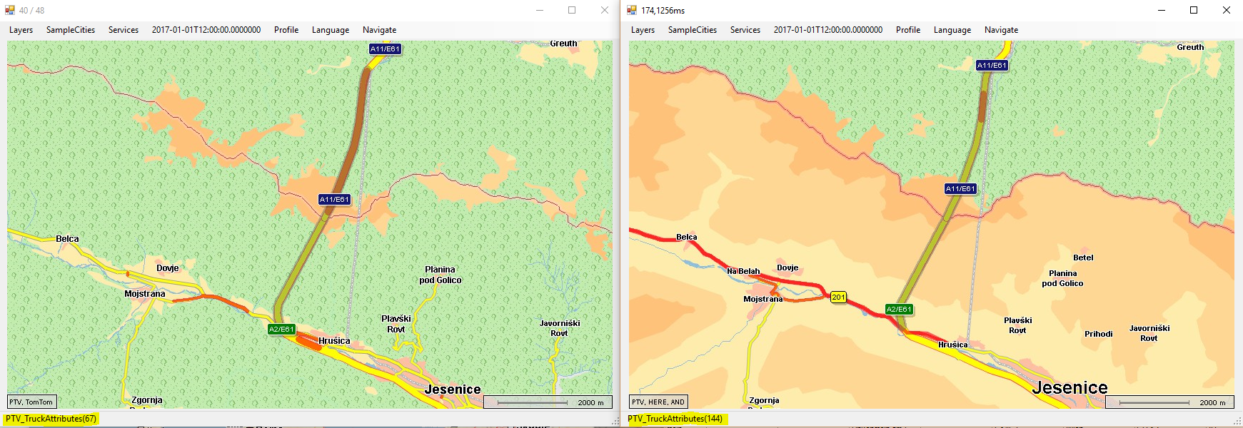

Map and guide makes use of Here map data. After trying our your route I'm sure that you are using TomTom map data. This is where the difference is coming from. The both have their own truck attributes data and depending on if everything is correctly modeled that can give big impact on comparing the 2.
For example:
In you example route Here has not truck attributen on the way, while according to TomTom there is a transit ban on the highway near Jesenice ( to be precise: ban for motorized vehicles heavier then 7500 kg with exception for delivery ).
Posts: 2865
Re: Truck restrictions
Here are some comparisons.
Close view to Karawankentunnel. Check the amount of TOMTOM data (left) and HERE (right). HERE seems so have more content.
Larger scale... same conclusion
Other region
Other region
As Joost mentioned: maybe it's worth checking the blockings / attributes in detail.
