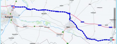

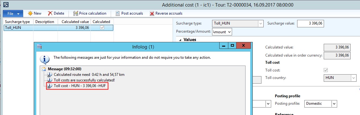

Example A (correct toll costs, without fuzzy radius waypoint)
Loading in Nagylak (HU), unloading in Szeged (HU), with one waypoint in Mako (HU).
Route is planned exactly thru waypoint, toll costs are calculated correctly and fully for whole Nagylak-Mako-Szeged distance, total 3396,06 HUF. Please note short diversion from highway in Mako waypoint, as route is „forced“ to go exactly thru waypoint. Here all correct & expected:

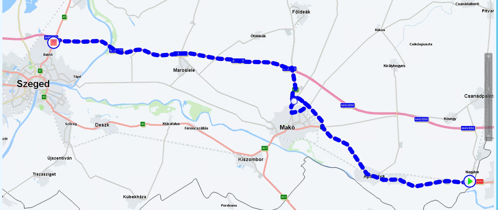

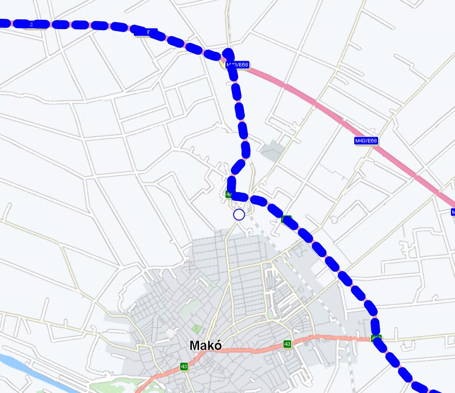

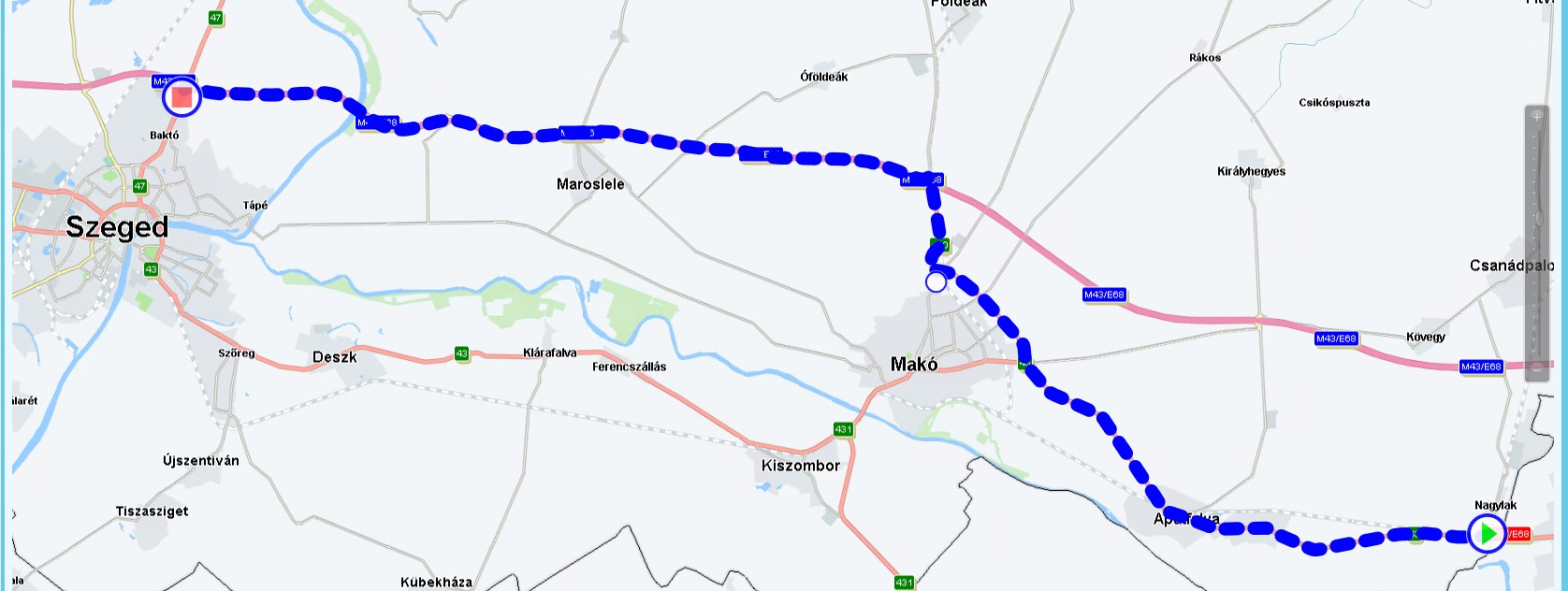

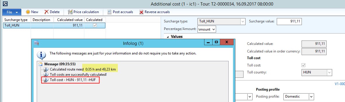

Example B (limited toll costs, with fuzzy waypoint Mako with radius 1000m)
Route is planned more direct, not passing exactly waypoint Mako. Which is good and expected:
But toll cost for this Example B are calculated only in amount of 911,11 HUF. Also please note the slightly faster driving time and shorted driving distance (=expected and correct), so distance & time calculation is working correctly for fuzzy waypoint:
Our suspicion is that toll costs were calculated till waypoint only, and not for road/segments afterwards.

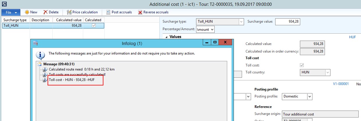

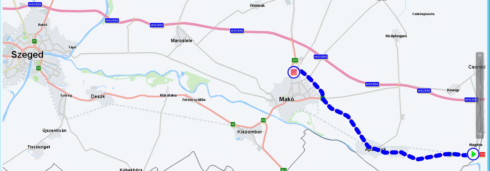

Example C (double check on toll costs).
Creating another test tour, from Nagylak (RO) till Mako (HU) gives following result (=good & expected):
The toll costs for such tour is 934,28 HUF, which is almost same as toll cost result as in Example B. So our Example B suspicion (=that for fuzzy radius waypoints system calculates toll costs only TILL waypoint but not AFTER this waypoint) seems verified:
