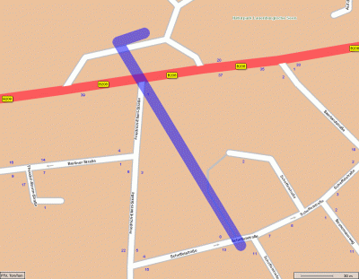

Hello Tobias,
I don't see a reason why this coordinate should fail.
LINESTRING(10.74839 53.69982,10.74798 53.69976,10.74977 53.69802)
What do you mean by "I am unable to put any waypoints on this street"? What happens instead?
Can you provide XML requests dealing with this?

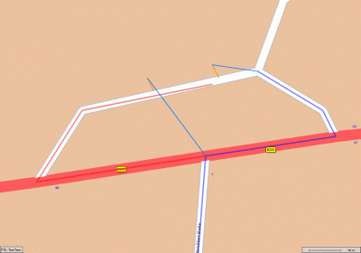

Re: Waypoints on specific street being ignored
From my understanding you should look at the linking types.
Orange = AUTO_LINKING,<br />Blue = NEXT_NODE
Blue = NEXT_NODE
The sample request uses NEXT_NODE and the NEXT_NODE is located on the national road B208.
I assume the AUTO_LINKING provides the result you want: your input coordinates are matched via the orange line.
Right?

Thanks, you are absolutely right!
Setting linktype to AUTO_LINKING worked like a charm.
