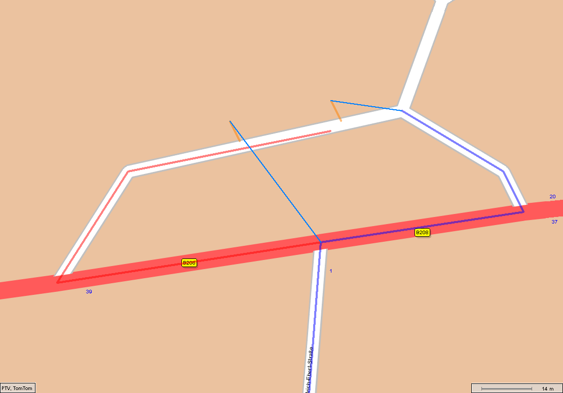

Re: Waypoints on specific street being ignored
From my understanding you should look at the linking types.
I assume the AUTO_LINKING provides the result you want: your input coordinates are matched via the orange line.
Right?
The sample request uses NEXT_NODE and the NEXT_NODE is located on the national road B208.I assume the AUTO_LINKING provides the result you want: your input coordinates are matched via the orange line.
Right?
Thanks, you are absolutely right!
Setting linktype to AUTO_LINKING worked like a charm.
Best Regards,
Tobias
