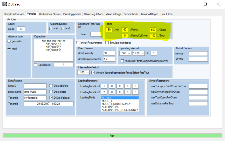

look at the attached screenshot.It is based on 10 exsting input tours.
By inserting the new order at this position in this tour we have to drive 3 km more than before. <br />Based on the cost properties of a vehicle 3km means 3km * ([cost/km])
Here are the cost properties of the vehicle
So each line in this grid represents a potential vehicle accepting the insertion, specifying the insertion position, the additional distance and period and the costs.
Does this answer your question?
PS: the first proposal is based on creating a new tour.
