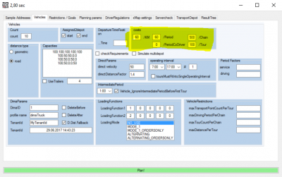

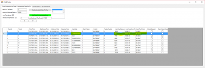

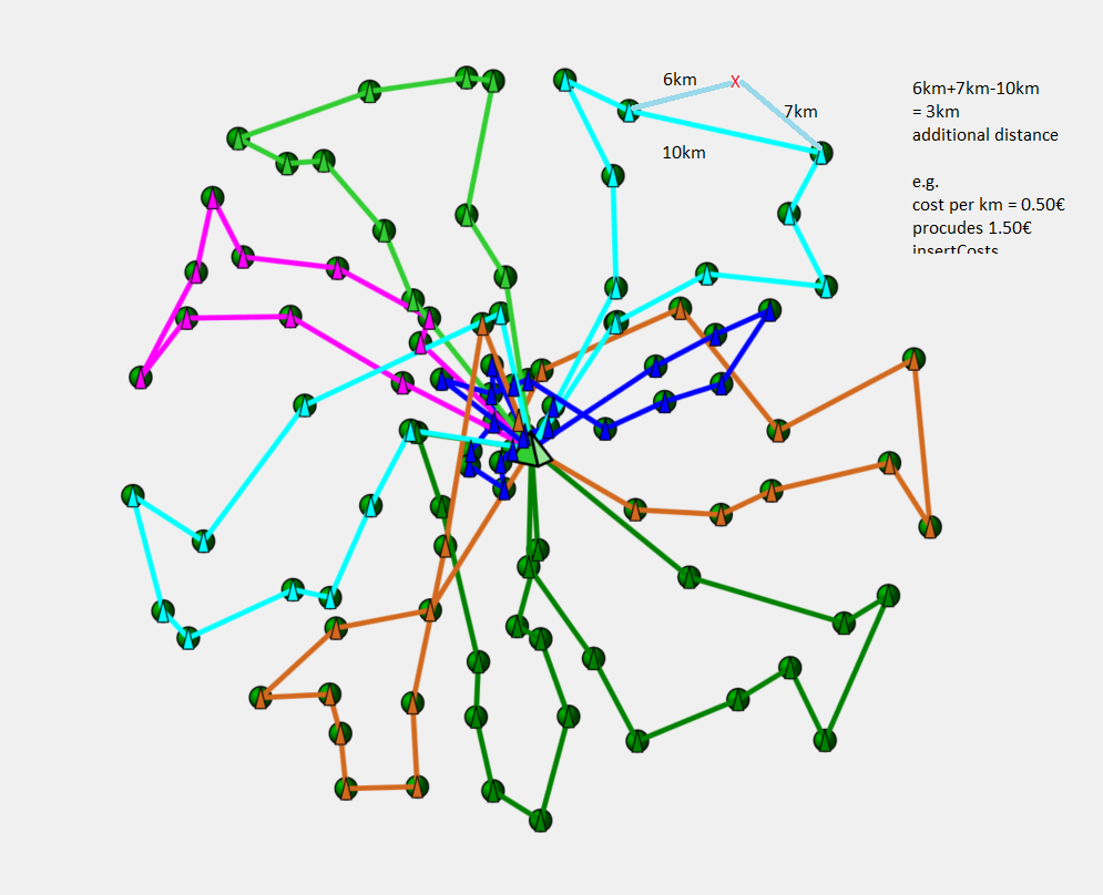

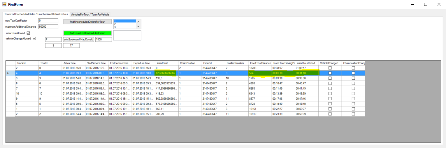

look at the attached screenshot.It is based on 10 exsting input tours. Does this answer your question?
PS: the first proposal is based on creating a new tour.
