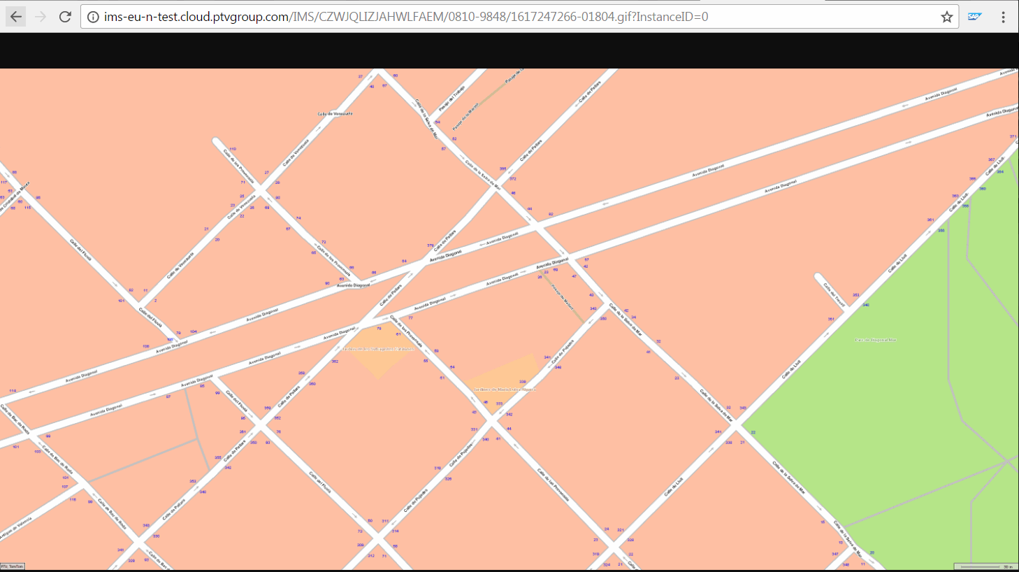

For painting a map tried using xMap operation renderMapBoundingBox i pass the leftBottom and rightTop from calculateRoute to renderMapBoundingBox.
The requested is:

And the response is:

The IMG is attached in post. But how i pass the route from Xroute to Xmap to painting it?

Dear Fran
please move your post/question to xMap-Forum, as your question is not SAP related.
Just a quick glance:
xMap doesn't know anything about (last) routing by xRoute.
You have to take the route (waypoints) from your xRoute response and to add this to your xMap request as addition.
Please refer to the xMap-API or examples of xMap-RawRequestRunner to see how to add objects to rendered map (e.g. POIs, routes etc.).

Coming back to the current question. You have various options to visualize geometries on a map (polylines, polygones, points...):
  • using native xMap layers scuch as CustomLayer or GeometryLayer. The image returned by xMap then contains the additional geometry. Usually on top of the streets and towns. This approach is becoming less and less popular.
  • nowadays the xMap server is more a backend service that returns a map based on streets, towns and core objects such as forrests, rivers, mountains. The additional geometries are then painted on top via a layer technology that is maintained outside the xServer itself. So for example by using web based frameworks such as OpenLayers, Leaflet or the PTV ajaxmaps.
