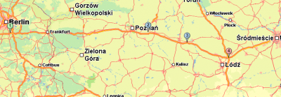

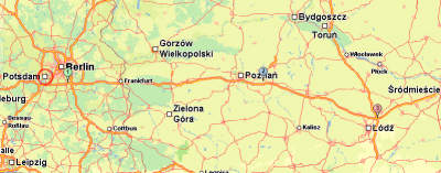

Ptv Map&Guide internet adds via points like that:
First we have: Start point has index 1.
Via point has index 2.
End point has index 3.
Now I want to add another via point somewhere near Frankfurt.
(This will be the second via point)
Now I have: Route will be like that : Start point -> Second Added via point -> First added via point -> End point.
So, my second via point has index 2, not 3.
But, if I add via point not in Frankfurt, but somewhere close to end point Łódź, situation will be different: Now, new via point has index 3.
Route will be like that : Start point -> First added via point -> Second Added via point -> End point.
There is some optimization going on there.
In my app (Windows app based on xRouteServer). Whereever i put my second via point i will always have:
And I would like for my app to bahave like Map&Guide internet.
Is it possible ?
Best Regards,
Krzysiek.

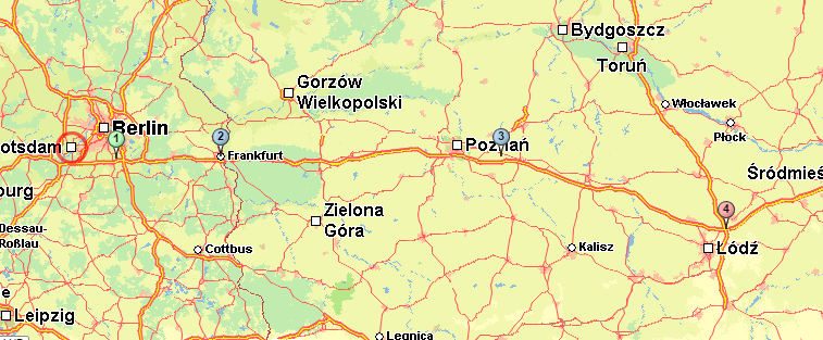

Screen was made on Map&Guide internet.
Now, user adds next via Point anywhere.
Map&Guide internet decides about its index.
Sometimes it will be in the end of via points list, sometimes it will be somewhere in the middle.
I suppose that It tries to resolve travelling salesman problem.
Am I right ?
Am I right ?

- Posts: 3042
Re: Via points sorting
Now I've been talking to Oliver.
The business logic within MAP&GUDIE Internet is simple:
We identify the index that causes the lowest detour via airline :
(improvised code
(improvised code
public int getInsertionIndex(WaypointDesc[] currentStationList, WaypointDesc wpd)
int index = -1, opt_detour = int.MaxValue;
for (int insertion = 0; insertion < currentStationList.Length - 1; insertion++)
int detour = airline(currentStationList[insertion], wpd);
detour += airline(wpd, currentStationList[insertion + 1]);
if (detour < opt_detour)
{ opt_detour = detour;
index = insertion;
return index;
}Bernd Welter
