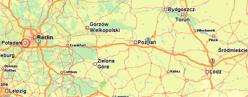

Ptv Map&Guide internet adds via points like that:
First we have:
Start point has index 1.
Via point has index 2.
End point has index 3.
Now I want to add another via point somewhere near Frankfurt.
(This will be the second via point)
Now I have:
Route will be like that : Start point -> Second Added via point -> First added via point -> End point.
So, my second via point has index 2, not 3.

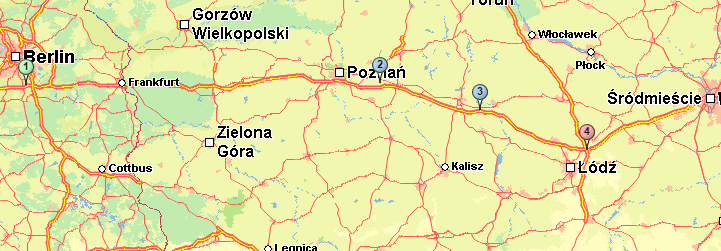

But, if I add via point not in Frankfurt, but somewhere close to end point Łódź, situation will be different:
Now, new via point has index 3.
Route will be like that : Start point -> First added via point -> Second Added via point -> End point.
There is some optimization going on there.

Screen was made on Map&Guide internet.
Now, user adds next via Point anywhere.
Map&Guide internet decides about its index.
Sometimes it will be in the end of via points list, sometimes it will be somewhere in the middle.
I suppose that It tries to resolve travelling salesman problem.
Am I right ?
Krzysiek Paziewski
