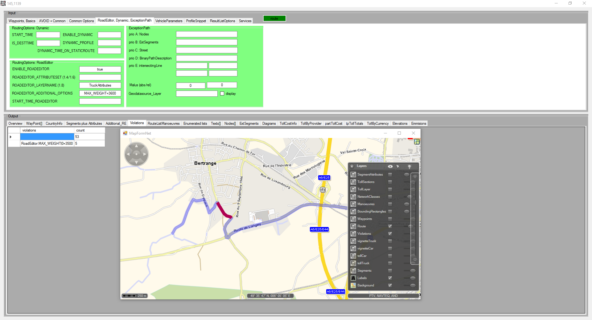

How to identify street segments that are blocked but used due to missing alternatives?

Hello Sorin,
I assume you need to gather the segments that are returned similar to this message taken from MAP&GUIDE Internet: The term you are looking for is probably the violation. Violations occur if a route uses segments with constraints (e.g. TruckAttributes) and the routing parameters allow such conflicts.
You can use the following parameters to request so-called "violation" information as part of the routing output:
- RoutingOption
- Via snippet / profile:
<?xml version="1.0" encoding="UTF-8"?> <Profile> <Common coordinateFormat="OG_GEODECIMAL" language="en" majorVersion="1" minorVersion="0"/> <Routing majorVersion="2" minorVersion="0"> <Course> <Violations> <SegmentBlockingViolations cost="50000" enabled="false"/> </Violations> </Course> </Routing> </Profile>

Re: Blocked segments
Thank you! It works!
- Posts: 3100
By the way: the cost value used in MAP&GUIDE Internet is 50000.
