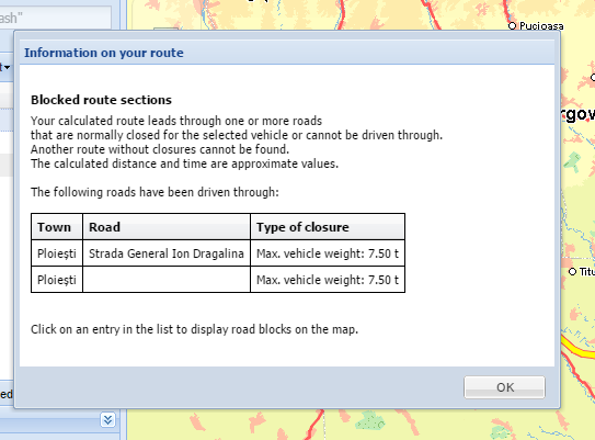

How to identify street segments that are blocked but used due to missing alternatives?
Thank you!
Posts: 2968
Re: Blocked segments
Hello Sorin,
I assume you need to gather the segments that are returned similar to this message taken from MAP&GUIDE Internet:
Message taken from MAP&GUIDE Internet
The term you are looking for is probably the violation. Violations occur if a route uses segments with constraints (e.g. TruckAttributes) and the routing parameters allow such conflicts.

Depending on the additional COST value the server will ignore some constraints if it is cheaper (virtually spoken) to drive through the conflict instead of performing a detour.
Sample route based on TruckAttributes violations. COST is set to 0. Routing takes regular track as without TruckAttributes but reports the conflicts.
The violations are reported in the RouteListSegment list (right). The column AdditionalRE just mentions that there are soem additional constraints - whether they are violated or not.

Thank you! It works!
