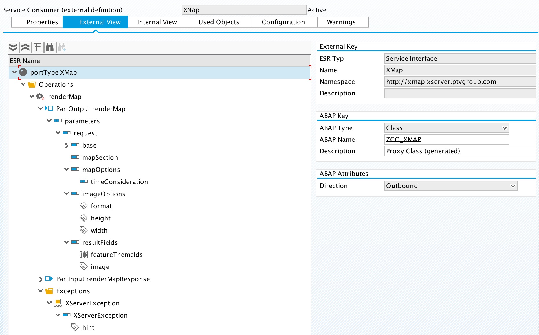

Dear Bernd,
I just tried to generate consumer proxy by SAP-Standard-Transaction SE80 for xMap->RenderMap out-of-the-box via WSDL (URL).
That was in the past often a critical task, because SAP was not able to use native WSDLs without manual rework.
To my real surprise it works instantly. Many thanks to the guys from PTV-Development. Everything seems to fit to the SAP-Requirements and specialties. Great job!
I'll proceed with other xServers. As far as I know the xLocate is a little tricky to configure/setup properly, next in my sequence will be xRoute and other releases of SAP (e.g. 7.40). But first of all I need to have the xServer2 running without any issue (see my post from yesterday).
Meta-Data:
WSDL-URL = http://localhost:50000/services/ws/XMap/2.1?wsdl
SAP = ECC 6.0 (7.02 Level 6)

Hello Mr.X,
thanks for the positive feedback (forwarded to DEV Teamlead
) and your further roadmap. I'm glad to hear that the integration of the services seems to work from scratch (once a server successfully starts) - I can remember times when it was a hard job to connect from SAP.
Let me know how I can enable you to set up your next milestones.
